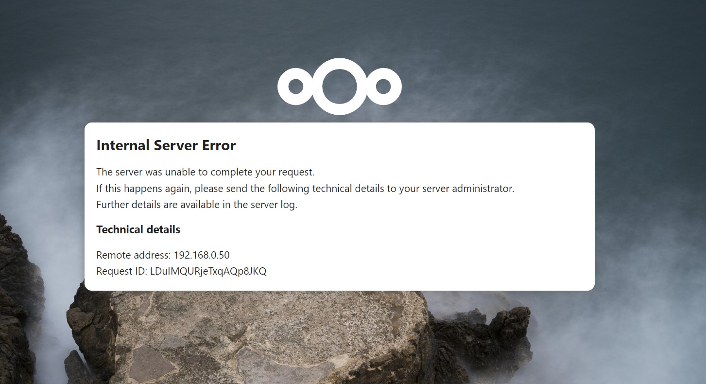

Hello to everybody,
I don't know if anyone already showed the version update problem.
Whenever nextcloud needs to be updated, at the end I get the following error:
Internal ServerError
(see screenshot).
I don't know how to fix, only way is reinstall via script.
does this happen to anyone else too?
Thanks in advance.

Hello to everybody,
(see screenshot).
Thanks in advance.
MB
We would need to see the log. This would be in
/var/log/caddy/caddy.log

bermau
Jul 4, 2017
28
Hi Victort,
I attach the log as indicated.
I specify that my jail is exposed on the internet through Caddy Reverse Proxy jail (Danb35 guide).
Reverse Proxy jail IP: 10.10.0.50
nextcloud jail IP: 10.10.0.55
thanks for your help.
MB
  • nextcloud-caddy-2023-01-19.txt
victort
Dec 31, 2021
973
Hi Victort,
MB
Ok. The log looks ok.
The reverse proxy part of this setup might be causing the issue. I have never run it that way.
When Nextcloud updates, I suspect it does something to the config that the reverse proxy doesn’t reflect. Not 100% sure what that could be though…
victort
Dec 31, 2021
973
Hi Victort,
MB
Can you share your Caddyfile for both the reverse proxy and the nextcloud?
I just set everything up like you described and was able to update without issue.

@danb35
I just did a reinstall, and am getting a 500 error also.
Reinstall detected, skipping generation of new config and database
RedisException: Permission denied in /usr/local/www/nextcloud/lib/private/RedisFactory.php:137
Stack trace:
#0 /usr/local/www/nextcloud/lib/private/RedisFactory.php(137): Redis->pconnect('/var/run/redis/...', 0, 0, NULL, 0, 0)
#1 /usr/local/www/nextcloud/lib/private/RedisFactory.php(178): OC\RedisFactory->create()
#2 /usr/local/www/nextcloud/lib/private/Memcache/Redis.php(43): OC\RedisFactory->getInstance()
#3 /usr/local/www/nextcloud/lib/private/Memcache/Factory.php(118): OC\Memcache\Redis->__construct('9fe6d94550f4813...')
#4 /usr/local/www/nextcloud/lib/private/Server.php(1120): OC\Memcache\Factory->createLocking('lock')
#5 /usr/local/www/nextcloud/lib/private/AppFramework/Utility/SimpleContainer.php(162): OC\Server->OC\{closure}(Object(OC\Server))
#6 /usr/local/www/nextcloud/3rdparty/pimple/pimple/src/Pimple/Container.php(122): OC\AppFramework\Utility\SimpleContainer->OC\AppFramework\Utility\{closure}(Object(Pimple\Container))
#7 /usr/local/www/nextcloud/lib/private/AppFramework/Utility/SimpleContainer.php(129): Pimple\Container->offsetGet('OCP\\Lock\\ILocki...')
#8 /usr/local/www/nextcloud/lib/private/ServerContainer.php(136): OC\AppFramework\Utility\SimpleContainer->query('OCP\\Lock\\ILocki...', false)
#9 /usr/local/www/nextcloud/lib/private/AppFramework/Utility/SimpleContainer.php(57): OC\ServerContainer->query('OCP\\Lock\\ILocki...')
#10 /usr/local/www/nextcloud/lib/private/Server.php(2070): OC\AppFramework\Utility\SimpleContainer->get('OCP\\Lock\\ILocki...')
#11 /usr/local/www/nextcloud/lib/private/Files/View.php(117): OC\Server->getLockingProvider()
#12 /usr/local/www/nextcloud/lib/private/Server.php(462): OC\Files\View->__construct()
#13 /usr/local/www/nextcloud/lib/private/AppFramework/Utility/SimpleContainer.php(162): OC\Server->OC\{closure}(Object(OC\Server))
#14 /usr/local/www/nextcloud/3rdparty/pimple/pimple/src/Pimple/Container.php(122): OC\AppFramework\Utility\SimpleContainer->OC\AppFramework\Utility\{closure}(Object(Pimple\Container))
#15 /usr/local/www/nextcloud/lib/private/AppFramework/Utility/SimpleContainer.php(129): Pimple\Container->offsetGet('OC\\Files\\Node\\H...')
#16 /usr/local/www/nextcloud/lib/private/ServerContainer.php(136): OC\AppFramework\Utility\SimpleContainer->query('OC\\Files\\Node\\H...', false)
#17 /usr/local/www/nextcloud/lib/private/AppFramework/Utility/SimpleContainer.php(57): OC\ServerContainer->query('OC\\Files\\Node\\H...')
#18 /usr/local/www/nextcloud/lib/private/Server.php(1472): OC\AppFramework\Utility\SimpleContainer->get('OC\\Files\\Node\\H...')
#19 /usr/local/www/nextcloud/lib/base.php(617): OC\Server->boot()
#20 /usr/local/www/nextcloud/lib/base.php(1144): OC::init()
#21 /usr/local/www/nextcloud/cron.php(43): require_once('/usr/local/www/...')
#22 {main}
Command: su -m www -c php -f /usr/local/www/nextcloud/cron.php failed!
Is this normal?
victort
Dec 31, 2021
973
@danb35
Stack trace:
#22 {main}
Is this normal?
So after going through the script there seems to be a bug. On lines 482-484 there are 2 commands concerning redis that should actually be run even when doing a reinstall, but they are bypassed if it is a reinstall.
On my resinstalled jail I ran both of them, restarted the jail, and now it’s up and running again.
# Add the www user to the redis group to allow it to access the socket
iocage exec "${JAIL_NAME}" pw usermod www -G redis
iocage exec "${JAIL_NAME}" chmod 777 /var/run/redis/redis.sock
@bermau
Can you try running these two commands from inside your jail after a reinstall?
EDIT: I added those two commands to the script right before it detects a reinstall, and ran the install again. It worked fine, and no errors, so I created a pull request on github.

bermau
Jul 4, 2017
28
hi,
sorry for the delay.
here is the caddyfile of the jail caddy (ip 10.10.0.50)
email myemail@email.com
nextcloud.mydomain.com {
encode gzip
reverse_proxy http://10.10.0.55
header {
enable HSTS
Strict-Transport-Security max-age=31536000;
redir /.well-known/carddav /remote.php/dav 301
redir /.well-known/caldav /remote.php/dav 301
I can't find any caddyfile in the nextcloud jail.
maybe you meant the config.php?
/usr/local/www/nextcloud/config/config.php
