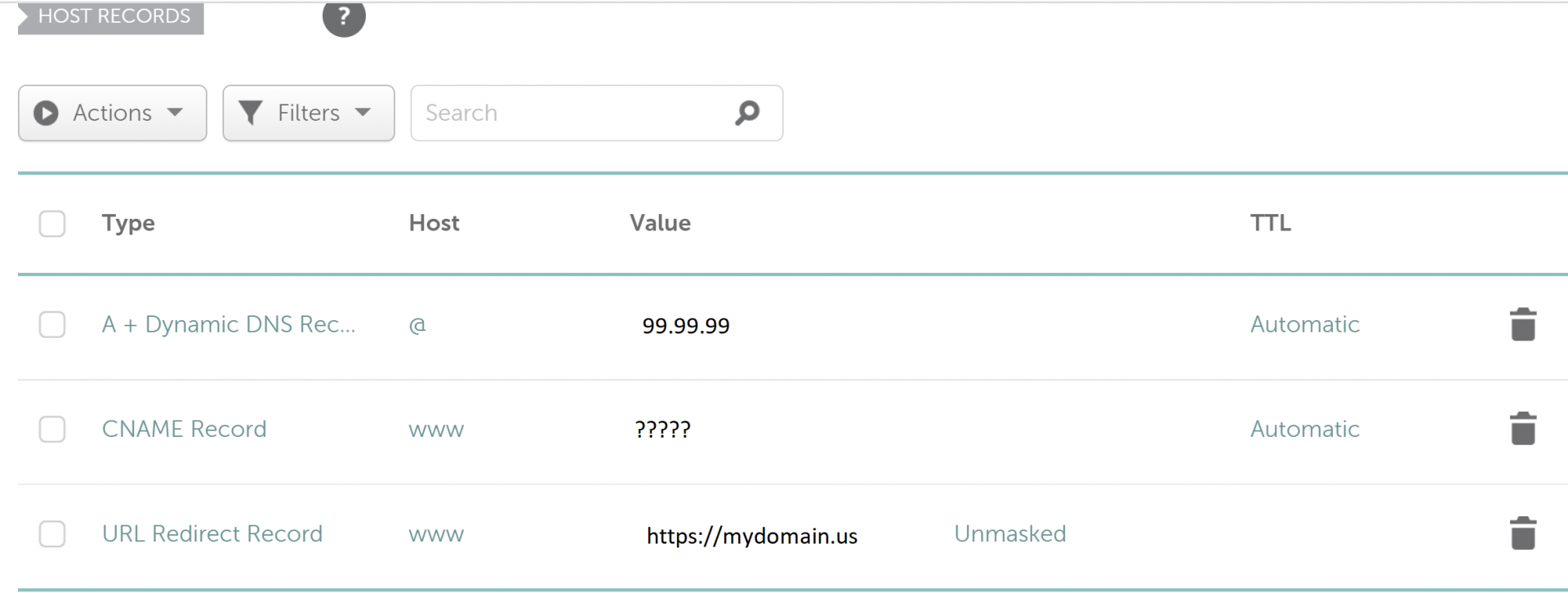

If the answer to the above question is yes. Then do I need to create an A record or anything like that from my domain registrar?
A CNAME would probably be the most appropriate, though it's with your DNS provider--who may, but need not, be the same as your domain registrar.

How would my Caddyfile in both instances look like? I don't want to just randomly taking thing out or add in things that I am not suppose to. I have the Caddyfile inlcluded above.

Also, I used namecheap for my DNS provider. What would the CNAME record look like?
What would host and value for the CNAME record be? I currently have this setup on namecheap.

15,504
No, you shouldn't randomly be making changes to your server configuration for something that's exposed to the Internet, and really, you should be doing some homework of your own to understand how to do this in the Caddyfile. I think I've given enough examples up-topic to get you started; beyond that, you may be better off asking at the Caddy community if the Caddy docs aren't clear enough.

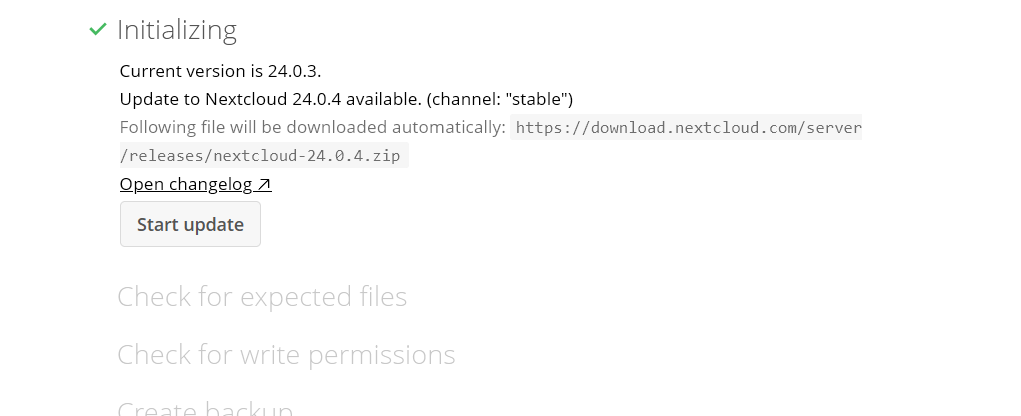

hello,
i used the script to install nextcloud; but i tweaked part of webservice ; ie i removed caddy and installed apache inside the jail.
is there some best way how to upgrade nextcloud only? ie keep all configs/db/ etc.. just nextcloud only. Currently running 24.0.3.
how do you guys manage that? maybe before any activity - the good idea is to create snapshot on dataset level jails/nextcloud and data-dataset nextcloud?
is it safe/ good idea to run official updater? https://xxxxx.ducxxxx.org/updater/
it shows something like >
thanks!

What I do (and its very scriptable), (1) put nextcloud in maintenance mode, (2) dump database and create snapshot of dataset for datastore and jail, (3) take nextcloud off maintenance mode, (4) backup datastore from snapshot, (5) backup application and database dump from snapshot
This method puts nextcloud out of action for just a few seconds and users general never notice it

For me the process of updating nextcloud in the jail is very easy. All nextcloud-data resides on a separate dataset which is mapped into the jail. I just update the application by whatever method I used for installing (ports or pkg). Then I connect to the webinterface. Typically some maintenance/conversion is done by nextcloud itself to update it's data structures. Sometimes I add some missing indices to the db afterwards (a simple command). That's it.
