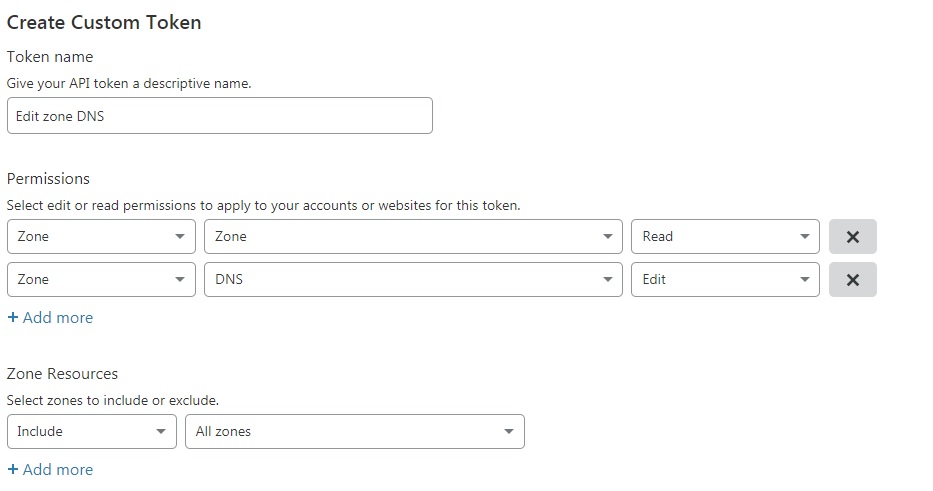

This looks like it would be your problem. Confirm that you're using an API Token (not the global API key), and that it has the appropriate permissions.
I logged into cloudflare and it seems that I cannot view the existing token, so i rolled it.
Now I have no idea how to update the nextcloud with the new token. :(
I checked in the caddyfile, but there is nothing like token in there.
Sorry. i am very new to this.
Here is the api token setting from cloudflare. Is this right?
Wizened Sage
11,877
There should be. It'd be in a section like this:
    tls {
        dns cloudflare api_token
Where "api_token" represents the token itself. If you've generated a new token, you'll need to change it in the Caddyfile. The permissions you show above look correct.
