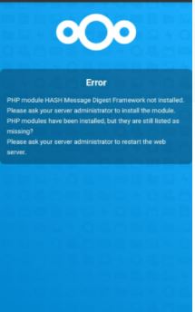

hi all, and mr.danb35 ,
my nextcloud was error , no one can access ,
if i try to access from mobile there's an error like the attached file
here are some errors regarding your setup.
  • It was not possible to execute the cron job via CLI. The following technical errors have appeared:
    • PHP module HASH Message Digest Framework not installed. Please ask your server administrator to install the module.
please advice how to fix it
i’ve just upgrade my nextcloud to latest version 20.
i’m running nextcloud on my Freenas Jail : Version: FreeNAS-11.3-U1
Regards,
Please help ..
Regards,
Please help ..
As i remember, i've just installed bcmath, theres notification on my nextcloud before, about bcmath, so in iocage freenas, i run pkg install bcmath, and after that,my nextcloud error, like above
and here's nextcloud error log :
2021/01/03 02:44:55 [ERROR 0 /index.php/] PHP message: PHP Fatal error: Uncaught Error: Call to undefined function OC\Security\hash() in /usr/local/www/nextcloud/lib/private/Security/Crypto.php:76

2021/01/03 02:54:58 [ERROR 0 /index.php/] PHP message: PHP Fatal error: Uncaught Error: Call to undefined function OC\Security\hash() in /usr/local/www/nextcloud/lib/private/Security/Crypto.php:76
Stack trace:
#0 /usr/local/www/nextcloud/lib/private/Security/Crypto.php(100): OC\Security\Crypto->calculateHMAC('005653983e83d76...', '+ykmWTsJrsrD11R...')
#1 /usr/local/www/nextcloud/lib/private/Session/CryptoSessionData.php(180): OC\Security\Crypto->encrypt('{"LAST_ACTIVITY...', '+ykmWTsJrsrD11R...')
#2 /usr/local/www/nextcloud/lib/private/Session/CryptoSessionData.php(74): OC\Session\CryptoSessionData->close()
#3 [internal function]: OC\Session\CryptoSessionData->__destruct()
#4 {main}
thrown in /usr/local/www/nextcloud/lib/private/Security/Crypto.php on line 76
2021/01/03 02:55:58 [ERROR 0 /index.php/] PHP message: PHP Fatal error: Uncaught Error: Call to undefined function OC\Security\hash() in /usr/local/www/nextcloud/lib/private/Security/Crypto.php:76
Stack trace:
#0 /usr/local/www/nextcloud/lib/private/Security/Crypto.php(100): OC\Security\Crypto->calculateHMAC('2e7d3d5244a71fb...', 'p5usljIngJR/v6w...')
#1 /usr/local/www/nextcloud/lib/private/Session/CryptoSessionData.php(180): OC\Security\Crypto->encrypt('{"LAST_ACTIVITY...', 'p5usljIngJR/v6w...')
#4 {main}
2021/01/03 02:56:59 [ERROR 0 /index.php/] PHP message: PHP Fatal error: Uncaught Error: Call to undefined function OC\Security\hash() in /usr/local/www/nextcloud/lib/private/Security/Crypto.php:76
Stack trace:
#0 /usr/local/www/nextcloud/lib/private/Security/Crypto.php(100): OC\Security\Crypto->calculateHMAC('241fc0397c0b381...', 'rqU3wdXkwpFFbmJ...')
#1 /usr/local/www/nextcloud/lib/private/Session/CryptoSessionData.php(180): OC\Security\Crypto->encrypt('{"LAST_ACTIVITY...', 'rqU3wdXkwpFFbmJ...')
#4 {main}
2021/01/03 02:57:59 [ERROR 0 /index.php/] PHP message: PHP Fatal error: Uncaught Error: Call to undefined function OC\Security\hash() in /usr/local/www/nextcloud/lib/private/Security/Crypto.php:76
Stack trace:
#0 /usr/local/www/nextcloud/lib/private/Security/Crypto.php(100): OC\Security\Crypto->calculateHMAC('f1ac9af9094e49b...', 'utgfq6N4kiDjr1k...')
#1 /usr/local/www/nextcloud/lib/private/Session/CryptoSessionData.php(180): OC\Security\Crypto->encrypt('{"LAST_ACTIVITY...', 'utgfq6N4kiDjr1k...')
#4 {main}
InGenetic
Dec 18, 2013
183
here my php module installed :
pkg: unknown command: -
For more information on available commands and options see 'pkg help'.
root@nextcloud:~ # php -m
[PHP Modules]
apcu
bz2
Core
ctype
curl
date
dom
exif
fileinfo
filter
ftp
gd
gmp
iconv
imagick
imap
intl
json
ldap
libxml
mbstring
memcache
mysqli
mysqlnd
openssl
pcntl
pcre
PDO
pdo_mysql
posix
redis
Reflection
session
SimpleXML
SPL
standard
wddx
xml
xmlreader
xmlwriter
xsl
Zend OPcache
zip
zlib
15,504
InGenetic
Dec 18, 2013
183
You say you just upgraded to Nextcloud 20; when did you create this jail?
on march 2020 , following your script, but today i've just upgraded to nextcloud version 20, when i build nextcloud , at that time nextcloud version was 18
as i remember i run this command on my freenas jail before it's broken :
pkg install php74-bcmath ,
and now if i run : pkg -m , on my freenas jail : shown like below :
For more information on available commands and options see ‘pkg help’.
[PHP Modules]
apcu
bz2
Core
ctype
curl
date
dom
exif
fileinfo
filter
ftp
gd
gmp
iconv
imagick
imap
intl
json
ldap
libxml
mbstring
memcache
mysqli
mysqlnd
openssl
pcntl
pcre
PDO
pdo_mysql
posix
redis
Reflection
session
SimpleXML
SPL
standard
wddx
xml
xmlreader
xmlwriter
xsl
Zend OPcache
zip
zlib
