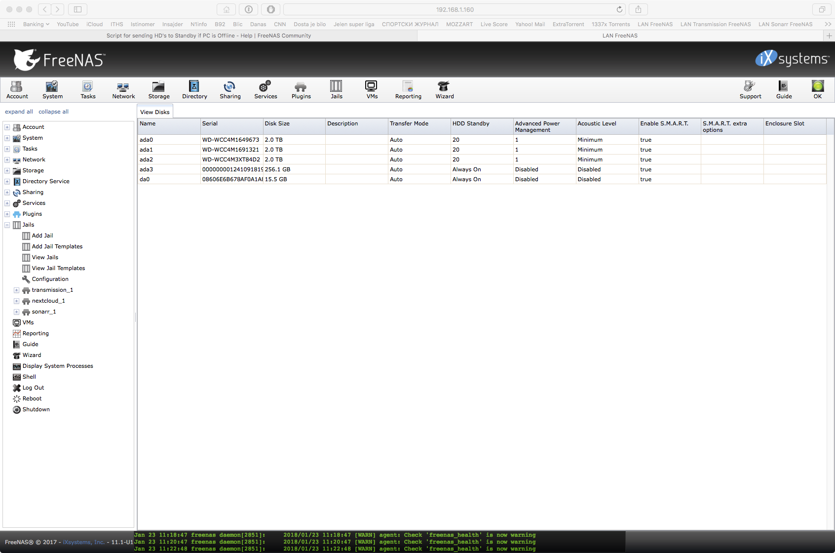

Using the normal x-min to sleep timer won't work in my case, cause I'm using an Fan Script that uses smartctl all 3 minutes, which resets the sleep timer. Also it will go to sleep to many times.
