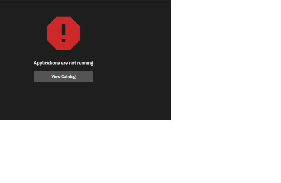

I previously had pihole running in a docker container on SCALE. I left for two weeks for a vacation and there may have been a power outage which caused an unexpected shutdown (this is my only guess at the issue).
Yesterday, I added a new router to my network which changed my default route from subnet 1 to subnet 0. That made me want to jump in and confirm pihole was still running in a docker container - I was greeted with the message in the attached screenshot.

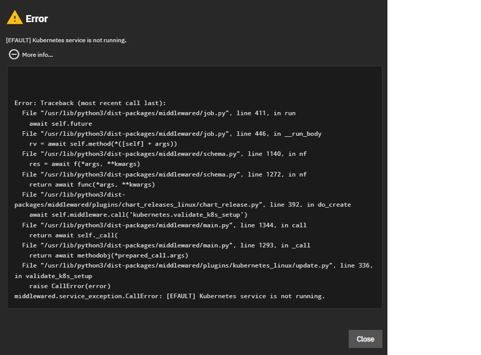

Below is the error I get when attempting to restart pihole from the official catalog
  File "/usr/lib/python3/dist-packages/middlewared/job.py", line 411, in run
    await self.future
  File "/usr/lib/python3/dist-packages/middlewared/job.py", line 446, in __run_body
  File "/usr/lib/python3/dist-packages/middlewared/schema.py", line 1140, in nf
    res = await f(*args, **kwargs)
  File "/usr/lib/python3/dist-packages/middlewared/schema.py", line 1272, in nf
  File "/usr/lib/python3/dist-packages/middlewared/plugins/chart_releases_linux/chart_release.py", line 392, in do_create
    await self.middleware.call('kubernetes.validate_k8s_setup')
  File "/usr/lib/python3/dist-packages/middlewared/main.py", line 1344, in call
    return await self._call(
  File "/usr/lib/python3/dist-packages/middlewared/main.py", line 1293, in _call
  File "/usr/lib/python3/dist-packages/middlewared/plugins/kubernetes_linux/update.py", line 336, in validate_k8s_setup
    raise CallError(error)
middlewared.service_exception.CallError: [EFAULT] Kubernetes service is not running.

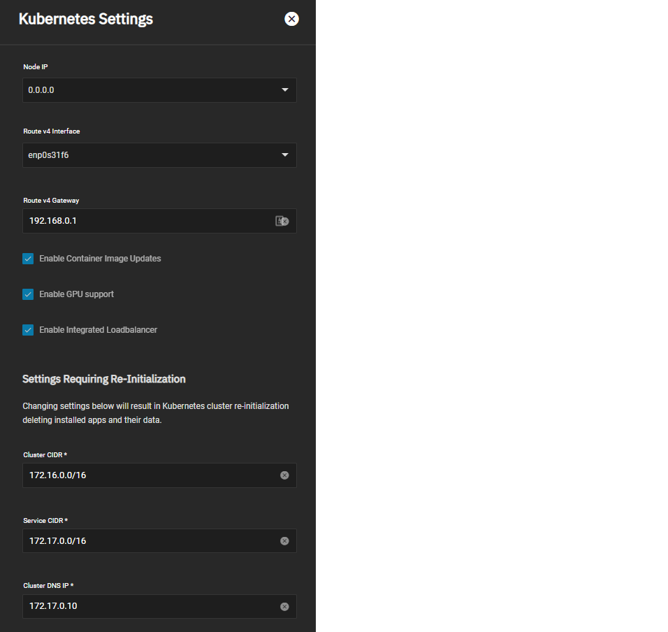

WN1X
Dec 2, 2019
77
Check the Applications -->Settings-->Kubernetes Settings. You may have the wrong IPv4 gateway defined.
jbarranco
Sep 7, 2022
11

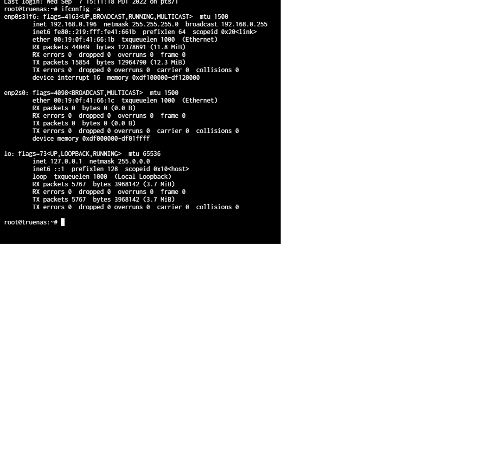

Thanks for the reply - I checked Kubernetes settings and Node IP is 0.0.0.0 which I assume is correct since its locally hosted on the SCALE server.
I updated the Route v4 Interface to be the Network Adapter ifconfig -a indicates has an IP assigned,
Also added the ip address of the DHCP server (router) as the Route v4 Gateway. I left the other settings as they were.
Still seems to be no progress. Same symptoms as above
