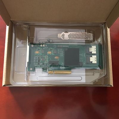

Do you think all these cards are ok ? :
- card 1 (fistjutsu not LSI, but same chip LSI 9211-8I M1015) @25$
- card2 (LSI 9200-8i SAS2008) @30$
Or is it usefull to put 2 x cards 4ports on 2 pci-e ? Freenas will see the 8 drives correctly and will make same raid as in a single 8ports card ?
Thank you !
9,700
This is the best option. Don't forget that you will need the breakout cables to give 8 SATA connections.
The other options you propose will also work, but perhaps not as simply and with no real benefit for the complication.
maybe should i get this LSI 9210 and flash it for IT mode ?
The included cables look like they may not be in the best condition, but otherwise it's the number 2 best option. Make sure to flash it into IT mode if you do get it.

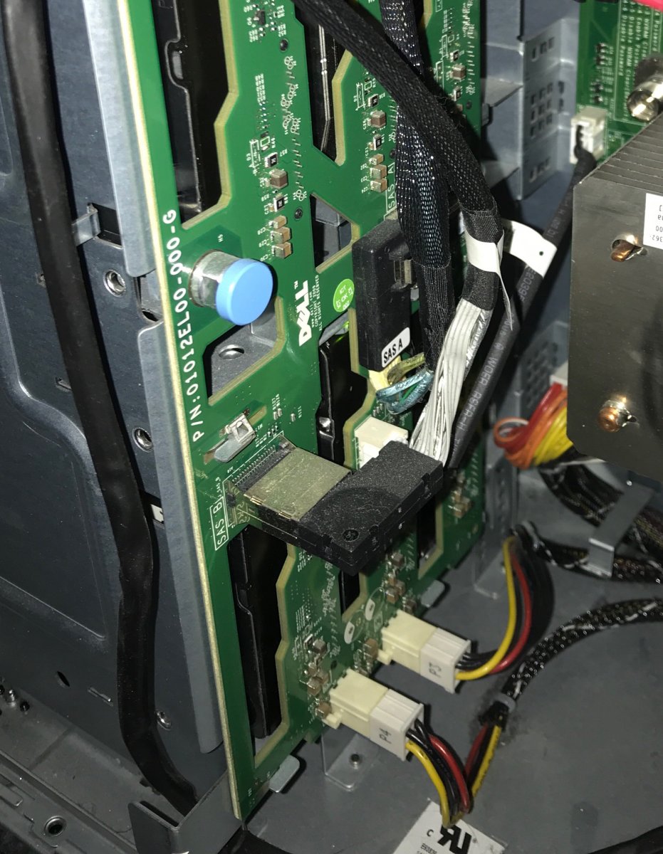

This is the back of my backplane.
I can imagine to unplug both minisas that are at this time connected to my perc 6i, and just plug to the new LSI9200 with 2 minisas to minisas. Do you think it is right ?
9,700
Sounds like it’s the right plan.
