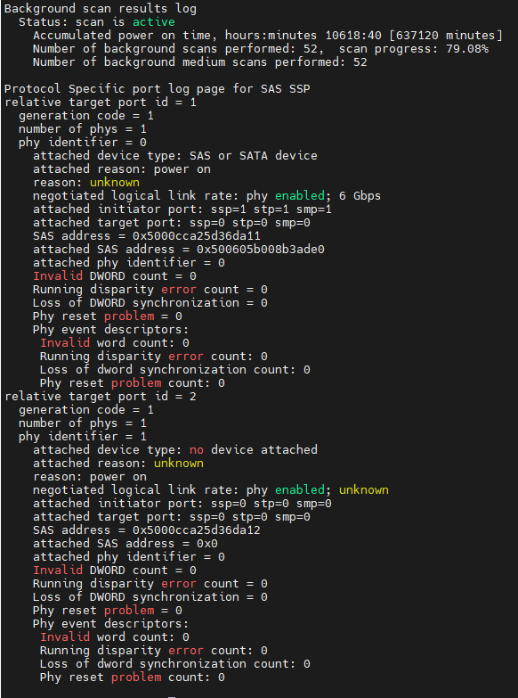

Is that all? It seems a bit limited and high-level. I'm also not sure why it's reporting multiple ports...
Octopuss
Jan 4, 2019
461
Well, the output was longer, but the beginning was identical to the previous screenshot, so I cropped just the extra info.

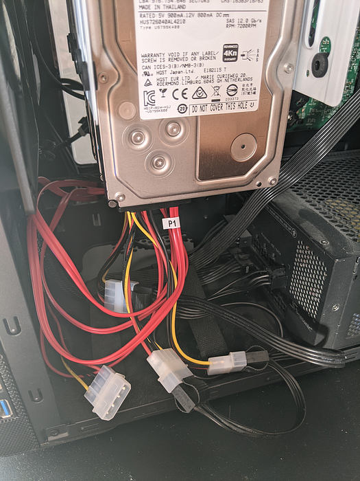

Do I have to power the server down in order to unplug a disk (not part of any pool) safely, or can I do that on the fly?
Depends on the server. You need a chassis with an appropriate backplane, it's not very safe to do this with bare cables. Although, unplugging a running disk shouldn't be too bad. Plugging in a disk is fairly likely to cause trouble with the PSU.
Octopuss
Jan 4, 2019
461
I didn't feel like shutting the entire server down (it's a little annoying when everything is virtualized), but I guess I better play it safe.
rvassar
May 2, 2018
972
The problem with bare cables you have no mechanical alignment, no rails to keep everything straight as the insertion occurs. So you run the risk of bending pins, and shorting PSU supply rails. It's just not worth the risk.
