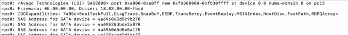

I was given the wrong information about this chassis, it's actually a 6G expander. So this means I only have 24Gbps available for each backplane, and after 8b/10b encoding that leaves me with 2400MBps. With a little overhead for SAS to SATA translation, I guess this is reasonable.
Now I have to figure out the other issue, which is that the OS will only see 28 out of the 36 disks! I believe this is a driver issue, it sounds just like this: https://redmine.ixsystems.com/issues/16372. I'm surprised Broadcom still hasn't fixed this in 3 years.
