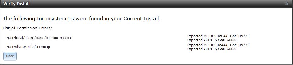

I also got this permissions issue when I verified my install.

Here is the output:
[root@freenas ~]# getfacl /
# file: /
# owner: root
# group: wheel
owner@:rwxp--aARWcCos:-------:allow
group@:r-x---a-R-c--s:-------:allow
everyone@:r-x---a-R-c--s:-------:allow
[root@freenas ~]#
