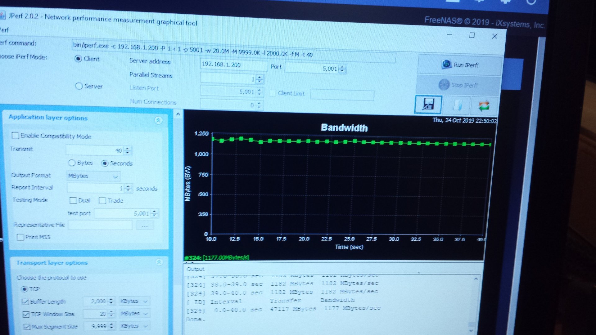

- network-speed (iperf-result): ~1200 MB/s (=max 10Gb line-speed)

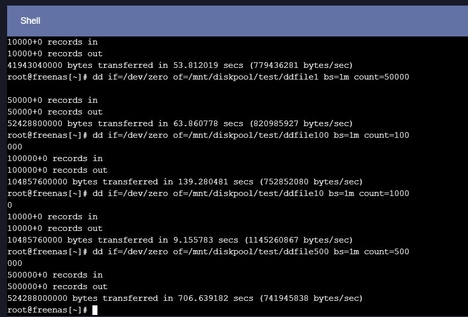

- diskpool-speed (dd-result): ~800-900 MB/s (the 8 disks can max do 8x200=1600 so loosing about half).

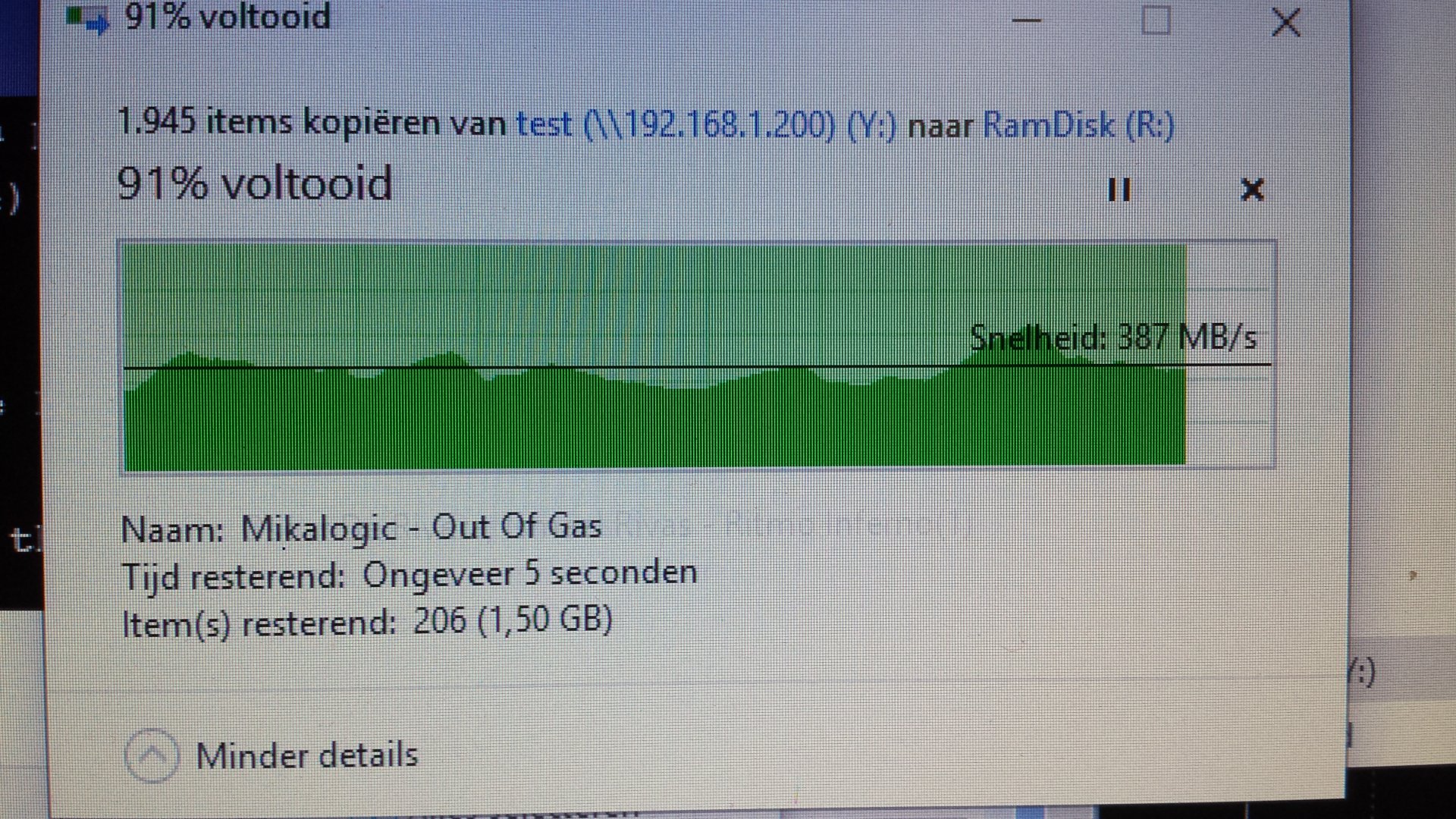

Yet, when copying/pasting from RAM-disk on WindowsPC to Samba-share on NAS, only max ~350 MB/s is what we actually get....

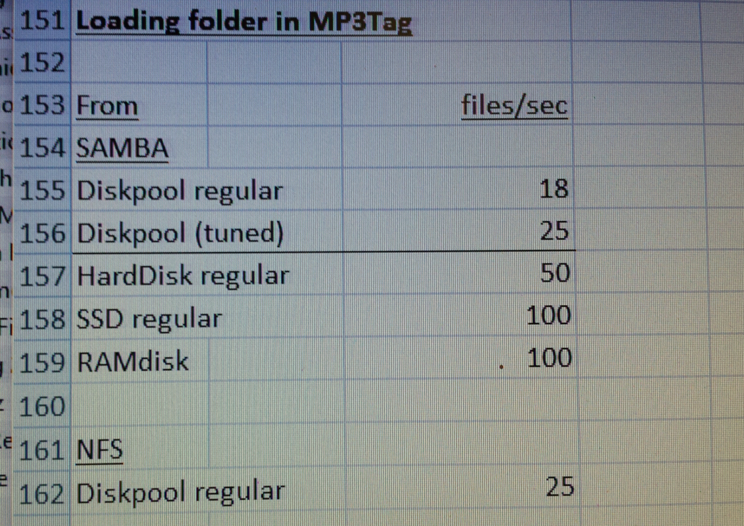

- loading a folder takes 2x more time than an old, single harddisk (25 files/sec vs 50 files/sec)
- deleting takes 10x more time than an old, single harddisk (100 files/sec vs 1000 files/sec)

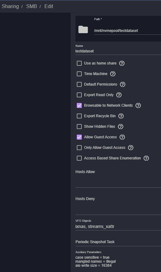

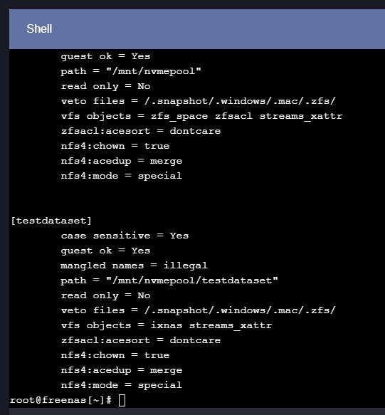

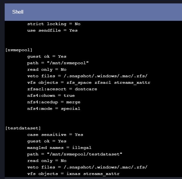

- Samba-share:
(changed VFS-objects + added some tunables in the Aux section)

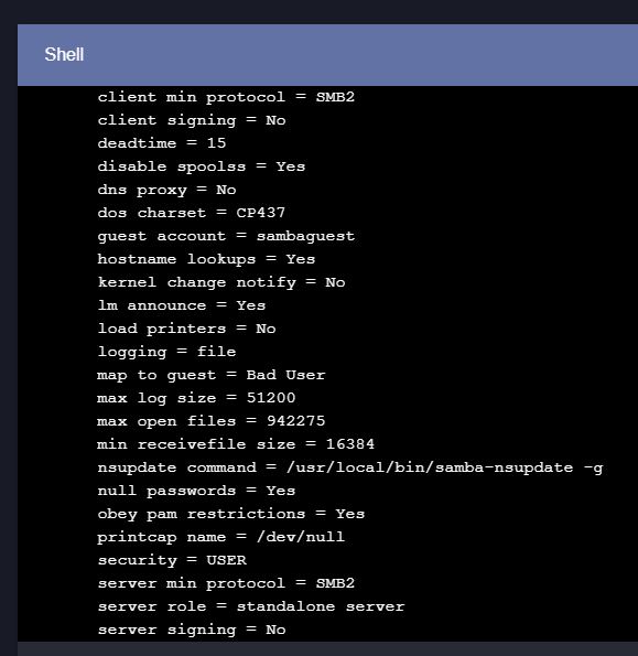

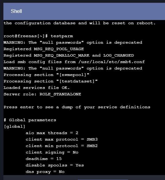

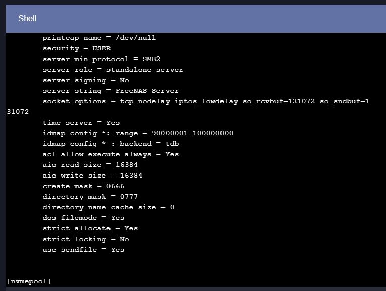

- SMB-config info: see attached picto's ('testparm' 1-5)
(added a series of general tunables in the SMB Aux section; this led to slower speeds; above 'actual speeds' are without these tunings)

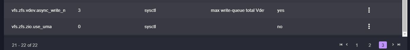

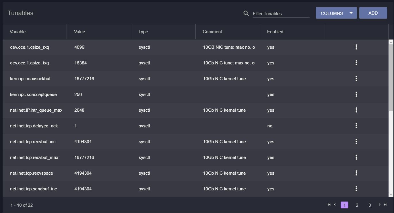

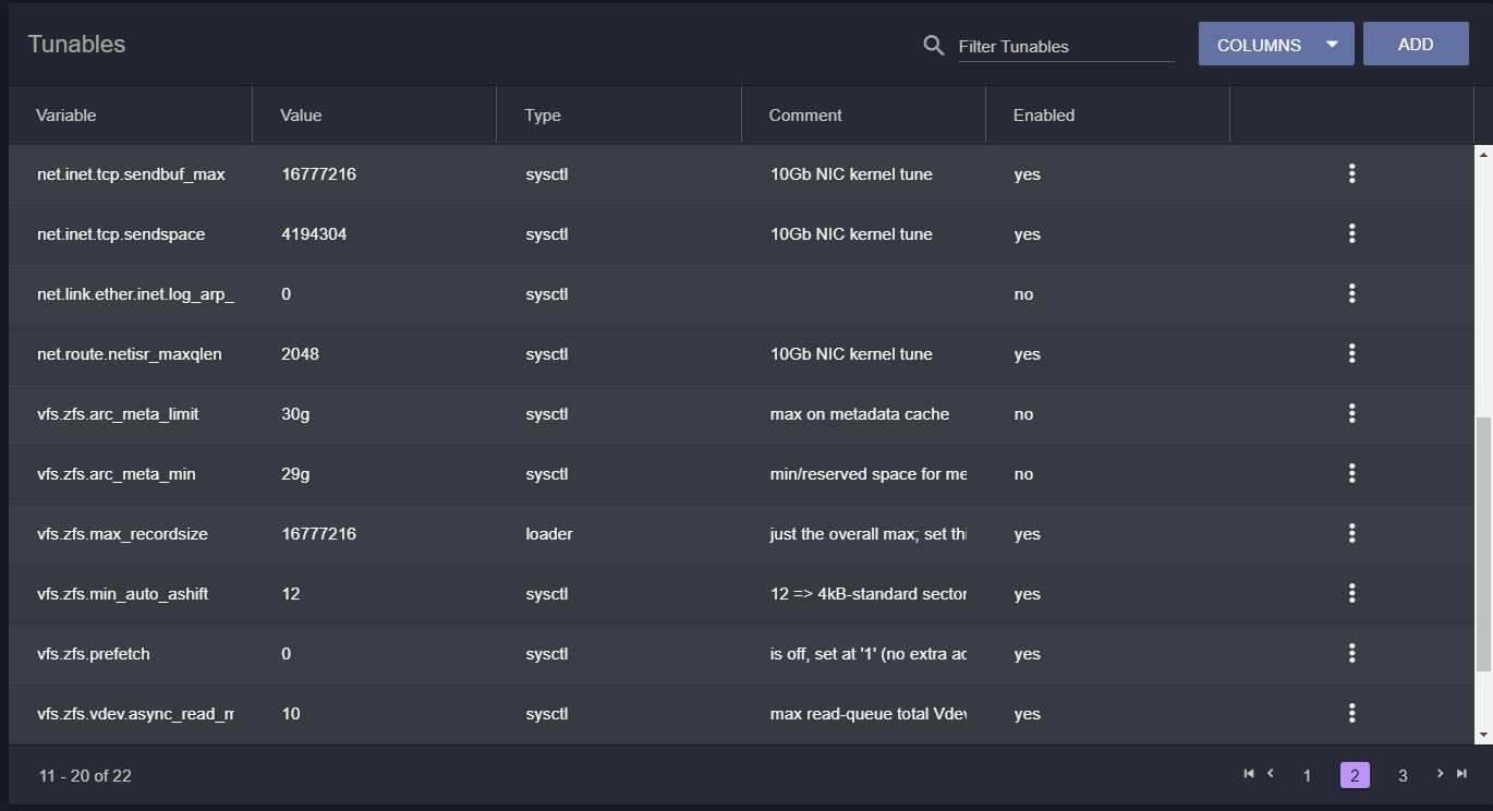

(Data on the used Tunables)(Not all are enabled)

  • Folder loading: (open a folder in MP3Tag; wait for all file-data/tag-data to be listed)
    • Diskpool (SMB Share tuned) on FreeNAS: 25 files/sec
    • Vs
    • Old, single harddisk under Windows: 50 files/sec.
    • So: very slow handling per file. Even when just loading the tagdata (not the audio/file itself)
  • File-deleting:
    • Diskpool (SMB-share tuned) on FreeNAS: 100 files/sec
    • Vs.
    • Old, single harddisk under Windows: 1000 files/sec.
    • So: very, very slow handling per file. Even when just deleting the file.
