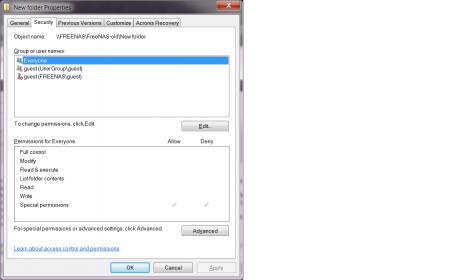

One additional difference that I have noticed between the hacked share and the non-working share is that whenever I check the folder security on the security tab of the folder properties, the group "Everyone" has a checkmark in the "Deny" column of the "Special Permissions". The hacked share does not have this. That's kinda difficult to describe. So, I have attached a screenshot.
