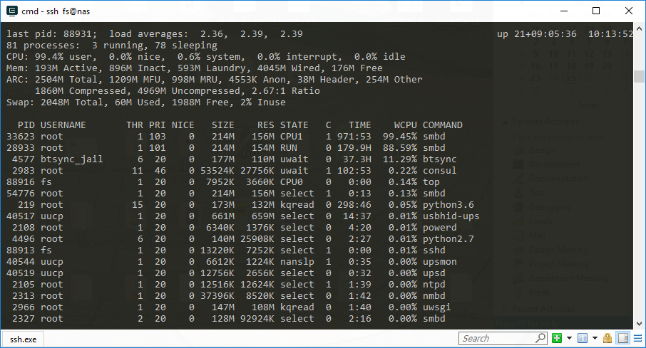

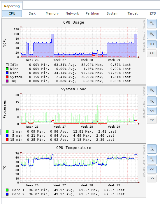

Hi all,
thank you for providing such a great software free of charge, and thank everyone in this forum for their help and patience.
We are running FreeNAS-11.1-U5 on a HP Microserver N54L, 6GB RAM, 2x3 TB SATA (mirror). The system has seen quite a bit of software upgrades, the first FreeNAS on this machine was 9.3 IINM.
We use this machine as a small (5-10 users) workgroup NAS with samba.
The system usually runs well, but after a while, a smbd process - and after more time, more smbd processes - begin to take up 100 % CPU. The user that interacted with that smb process experiences hangs on their windows machine when trying to do anything with the NAS. We already had data/work lost that was in the making more than once :(
When this happens, I can't kill -HUP or regular kill the process on the command line, it does not react.
I have not found any real clues yet. Any help debugging this would be appreciated. I attach winbind and smbd log excerpts, TOP, and a copypasta from a backtrace in a gdb that I attached to the stalled process. I looks like it is doing something with xattrs and/or shadow copy a lot. But when I try to trace the process with truss, it comes up empty (maybe I'm using it wrong?) so it more looks like a deadlock to me than real work. I have no dtrace experience unfortunately, if that would help I would be glad to collect some data.
How to go on with troubleshooting?
  • nas-2018-07-25-top.txt
  • nas-2018-07-25-smbd-backtrace.txt
  • nas-2018-07-25-log-wb-nas-example.txt

anodos
Sambassador
Mar 6, 2014
9,553
Use top to find a pid that's spinning at 100% cpu, then increase it's log level via smbcontrol <pid> debug 7 for a few seconds, then drop it back down smbcontrol <pid> debug 1 and upload /var/log/samba4/log.smbd.

The goal isn't to kill the smbd process. We want to know what's going on in it. If it doesn't respond to smbcontrol, then get the following:
1) pcap of traffic
tcpdump -i YOUR_NIC -p -s 0 -w FILENAME port 445 and host IP_ADDRESS_OF_THE_CLIENT
2) Sample truss output for the pid.

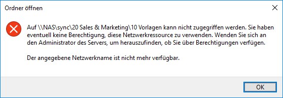

On the user side
I attached a screenshot of the error message that Sophia gets when she wants to work on the NAS. Looks like a time out to me. (It's German - the last line translates to "The specified network name is no longer available.")
What next? I tried generating a backtrace in gdb - that most often comes up looking like that specific smbd instance is doing something regarding xattrs - to see that, please refer to the attachment section of my original post.
