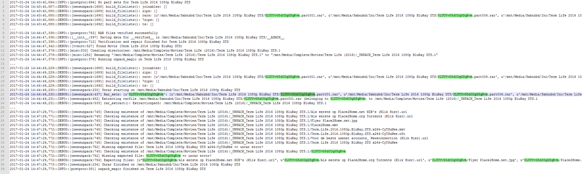

I've just updated to v1.2.0 and imminently since I started a download it wouldn't unrar correctly. It says "Unpacking failed, an expected file was not unpacked"... It says that when it should be finished unraring. I can open and watch downloaded files though, they're just in the _UNRAR_ folder
Some downloads it would and some it wouldn't unrar, depends on the uploader I noticed.
Did a reinstall of the jail and no change in result
I enabled debug logging: (see added photo of the log)

Kan je handmatig parren en unrarren? Misschien is je download incompleet? Kan ook aan SAB liggen hoor.
xmicks
Apr 28, 2016
33
Copied to my local harddrive, extracted it and indeed incomplete download. But strange since sab already repaired the download. Also strange fact is that I can open the file, skipped through it and it plays every part of the file.
Maybe the repair par2 service is not working correctly. But I should add to it that it repairs other downloads correctly. Just some downloads show this problem.
Any suggestions on how to proceed?
