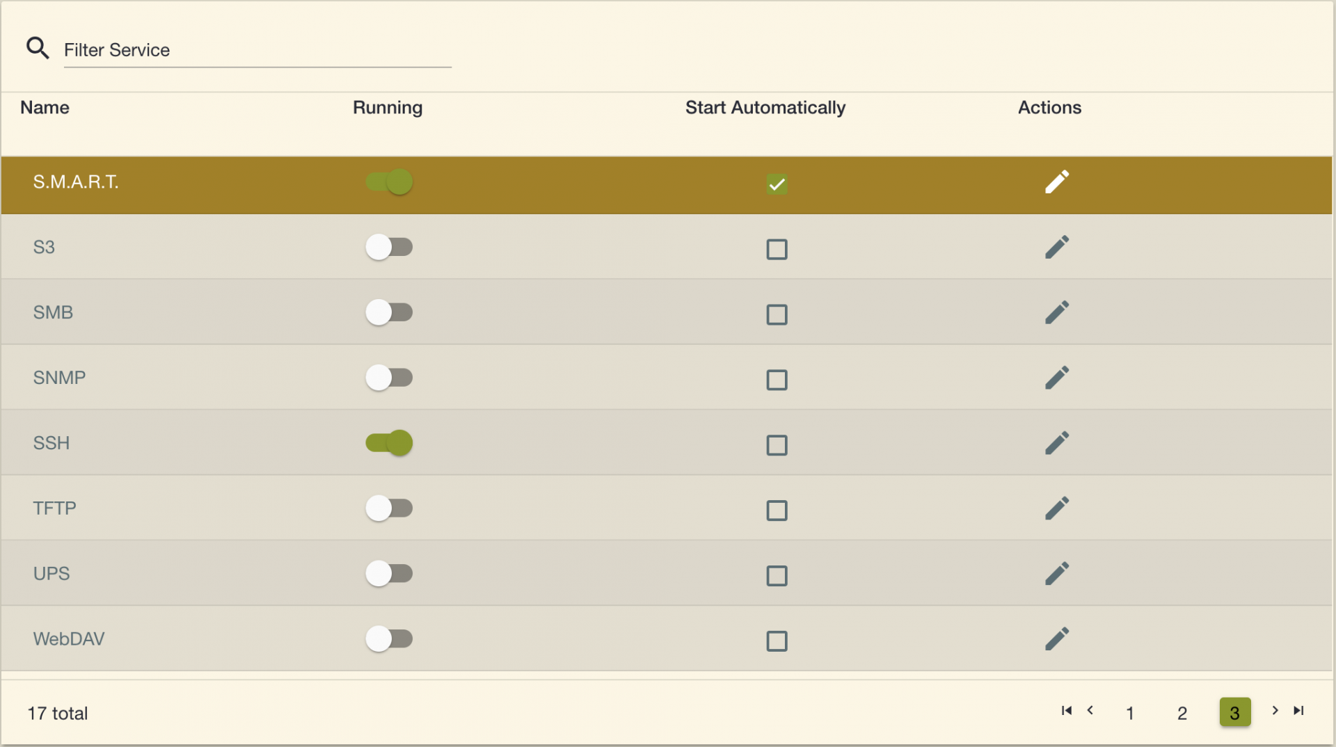

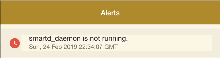

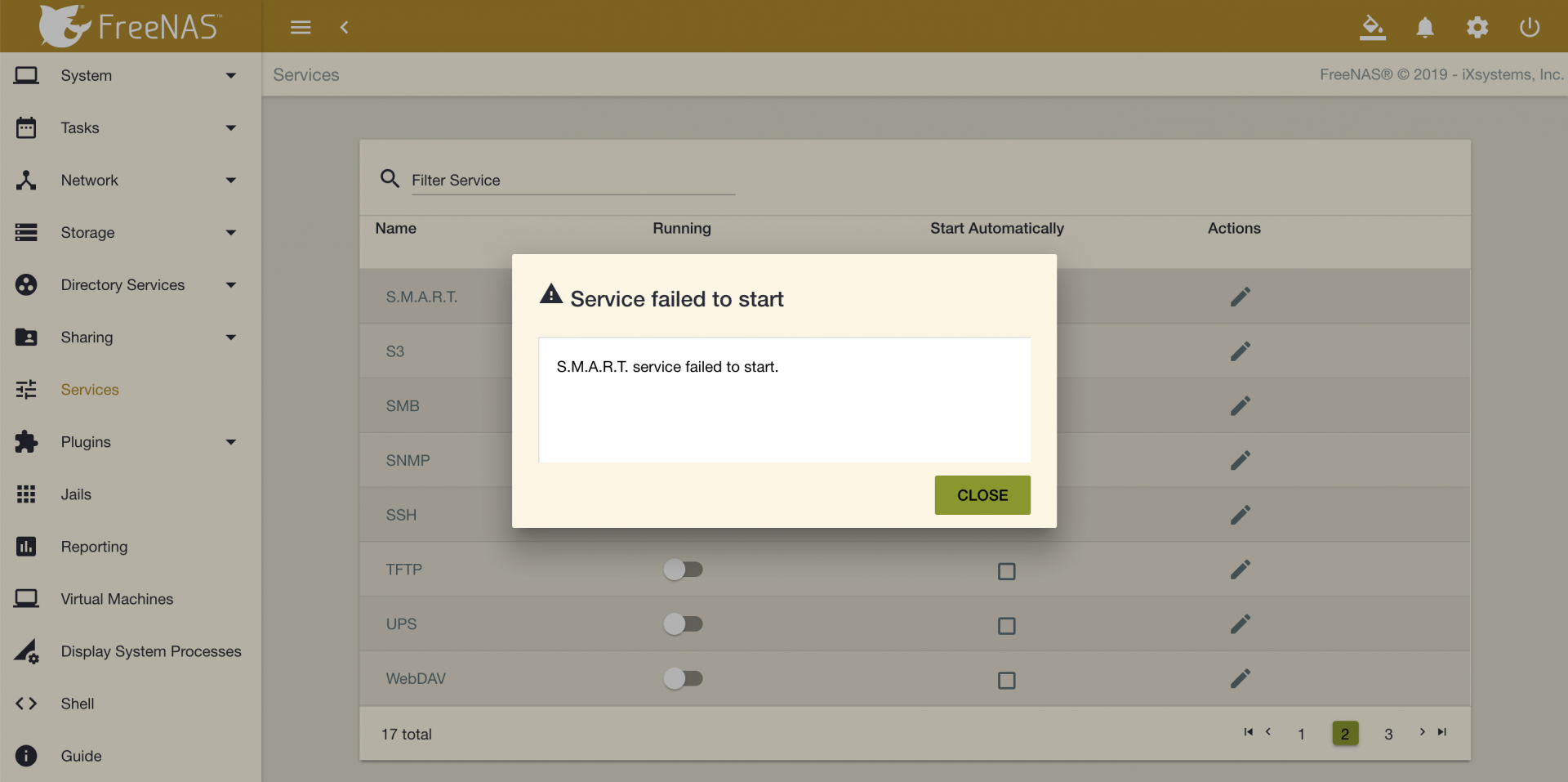

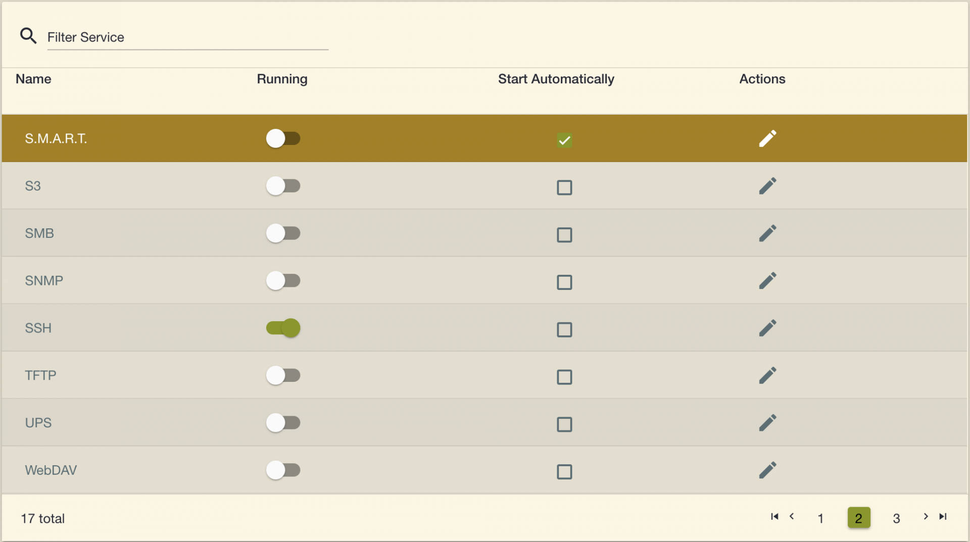

I got a report that the smart daemon stopped running. When I navigated to the services list and attempted to restart the service I get an error saying that it is unable to start the service. If I navigate away from that menu and back I unexpectedly see the service listed as running. `$ ps aux | grep smartd` reports the service as running as well. I'm interested in what is causing the error to appear in the first place and whether it was something I did and whether I should feel comfortable that my disks are in fact being monitored given that the service is listed as running. I have attached some error logs found from `/var/log/debug.log` as well as my smartd.conf and relevant screen shots.
I am running 11.2-U2.
I posted a bug about this at first but thought that perhaps I should post here as well in case it was my error. The bug can be found here.
  • smartd.conf.txt
  • bug_report.txt

Oct 18, 2018
969
Alright, so I turned off the process in the UI and then killed the PID (it was still hanging around after the UI reported SMART services as off. I then tailed /var/log/daemon.log when I restarted it in the UI.
It looks to me like the daemon is running just fine. Based on the error found in /var/log/debug.log that I posted in my original message it seems like perhaps the issue lies in some of the UI .py code? I haven't had a chance to dig in today any more on those errors.
