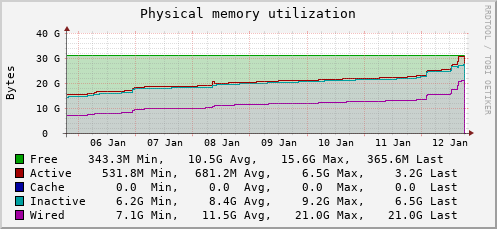

wackymole
Aug 21, 2017
59
So, the devs are still investigating, but have no leads right now. So l will continue to search for symptoms and potential causes.
1) I have strong reason to believe that is it is memory (ram) related. ( My system seems to die when I use all my ram)(memory leak bug is not helping, should be patched in the next update)
2) Power management or motherboard power saving could also be related. ( Cool'n'Quiet and power optimiztions)
I have three primary questions?
1) Is everyone running ECC ram in a compatible motherboard?
2) Is anyone getting crashes running non-ECC ram?
3 What motherboard are you using? -- (mine- ASRock AB350 PRO4)
Have a great week!-- Cheers
