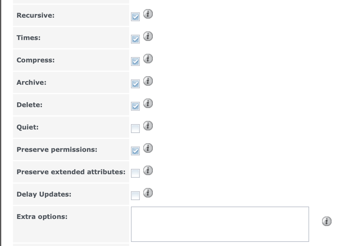

Your assumption is correct. I have the check box next to delete selected. Here is a screen shot showing the options selected.

If you hover over the "i" next to the checkbox, you'd see that "Delete" means rsync will delete those files on the destination that do not exist on the source.
Try unchecking the checkbox next to "Delete" and see if your problem goes away. This should not do you any harm, but will leave some files on the destination that you probably wanted deleted.
By default rsync runs as root on destination. Just to confirm, the user field in your rsync task has "root", right?
If so, is your destination folder somehow read-only even to root? What kind of a system is that? Can you post the result of "ls -al" on the destination folder?

The target for the rsync is a freebsd server that does not permit root login. The rsync user on the freenas is a user with sudo privileges that logs into the freebsd target by ssh with a key. I don't believe this is a user/permissions issue because there is no problem with writes -- only deletions. If I uncheck the delete box, the task completes without an error. If the delete box is checked I get the "IO error encountered -- skipping file deletion" message.
