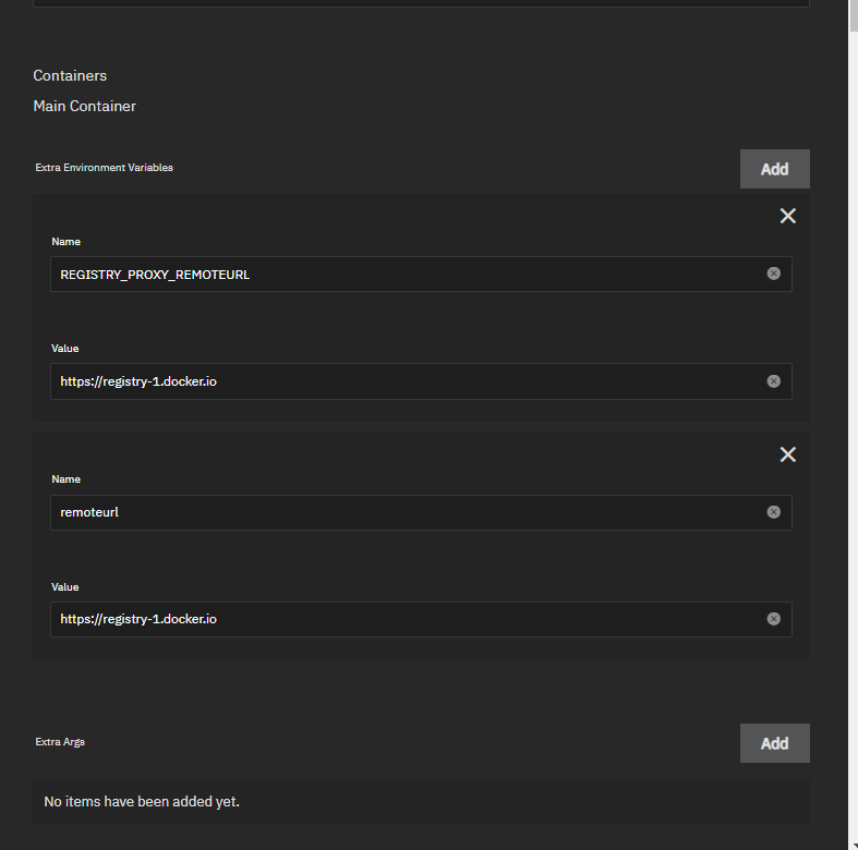

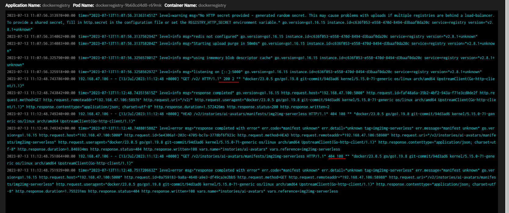

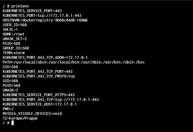

I have added the docker registry app to my TrueNas Sacle. Its running but i see clients just get this error 404 err.message="manifest unknown" when they try to get pull an image. I have tried edit extra EV as follows. also try leaving it blank. but the same problem. any suggestion why?
to when i shell i can see there is not urnal for https://registry-1.docker.io as I would expect

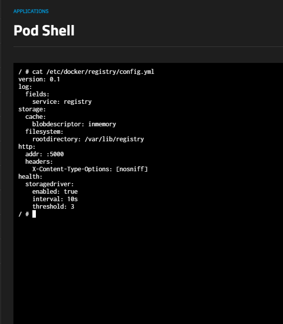

The problem is that it's not setting up as a pull though cache. The config file needs a sections at the end where it defines the proxy server. But I can't find away to edit it and add it.
i have used code server to make new file cat /etc/docker/registry/config.yml and addedd the content
proxy:
remoteurl: https://registry-1.docker.io
username: [username]
password: [password]
But some reason that does not presistance between restarts.
It there away to fork the app so I can modify it?
etherion
Jul 13, 2023
6
Here is the /etc/docker/registry/config.yml
I need to find away to add
proxy:
Then it will act as a mirror

OK, so I put a file called config.yml in a directory on my TrueNAS host and put the contents needed in that file.
Then I edited the app to add "Additional App Storage" in the Storage and Persistence section.
I set the Host path type, then set the host path to that directory I created and set the mount path to /etc/docker/registry.
Started the app and logs now say:
2023-07-14 12:01:36.089443+00:00time="2023-07-14T12:01:36.08930899Z" level=info msg="Registry configured as a proxy cache to https://registry-1.docker.io" go.version=go1.16.15 instance.id=e24a514d-a760-4bae-8b7c-0ecf297b45ed service=registry version="v2.8.1+unknown"
Looks like what you wanted.
