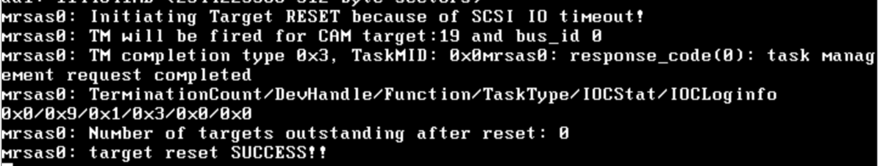

Alas, after an hour, it does indeed get past xpt_config, but then just loops the messages in the image. Any Hail Mary? :D
Dec 29, 2014
1,135
Hmm. Mine didn't do that. :-(
