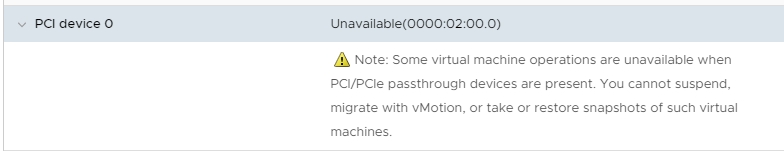

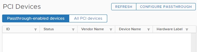

OK, explanation and conclusion for all of you who read this threat searching for solution:
Three main issues:
1. BE AWARE: VMWare 7.0 does NOT install a scratch Disk if you install on USB-STICK! That means: you will never be able to store all of your configuration and after reboot you will have the old configuration again! Configure your scratch disk: https://blogs.vmware.com/vsphere/2020/07/vsphere-7-system-storage-when-upgrading.html
2. DO NOT USE Dell customized
VMware-VMvisor-Installer-7.0.0-16324942.x86_64-DellEMC_Customized-A02.iso
if you want to passthrough HBA330!
If you attach disks to your controller the passthrough is not possible anymore! Use the original VMWare iso:
VMware-VMvisor-Installer-7.0b-16324942.x86_64.iso

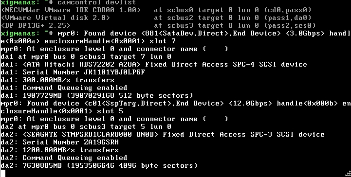

3. If you try to passthrough HBA330 on Dell R730 you will tap into a serious Dell-ISSUE:
During SOME boots (e.g. 1 of 5) your system will hang at
mpr0: Out of chain frames, consider increasing hw.mpr.max_chains.
mpr0: Calling Reinit from mpr_wait_command, timeout=60, elapsed=60
mpr0: Reinitializing controller
This issue could not be solved from Dell until now (you will find several threats about this issue).
- If you are using HBA330 as PCI-Card: using another port can help.
- If you are using HBA330 MINI: you cannot workaround the issue.
