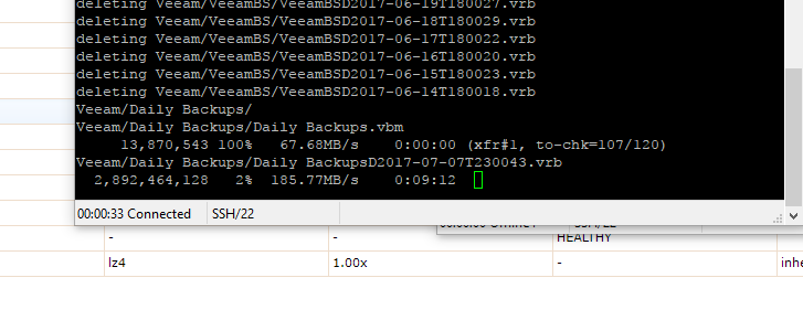

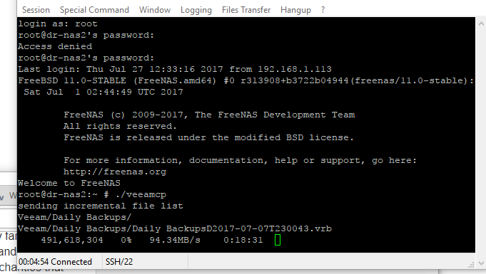

Hello there, I recently upgraded from FreeNAS 9.10.2-U5 to 11.0-U1 and I'm having a problem with Rsync write speeds between volumes since the upgrade.
We have two local volumes, one that is our daily backups(Backup1), and one that Backup1 Rsyncs its data too(Backup2). Since the upgrade to 11.0 the speed has been cut in half, I've included screenshots of the before and after speeds. Usually it sits around 180 to 200 MB/s, but now its around 80 to 100 MB/s. We run Rsync through a script on our FreeNAS box.
