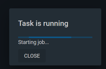

Problem: Recently upgraded to 11.3 U1. and Rsync task is now sitting on 'Starting Job' forever (at least 24hrs now). I thought it was odd at first but just left it overnight thinking it might need to do a treewalk before starting or something.

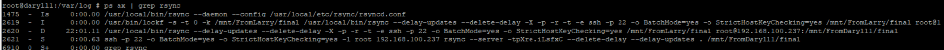

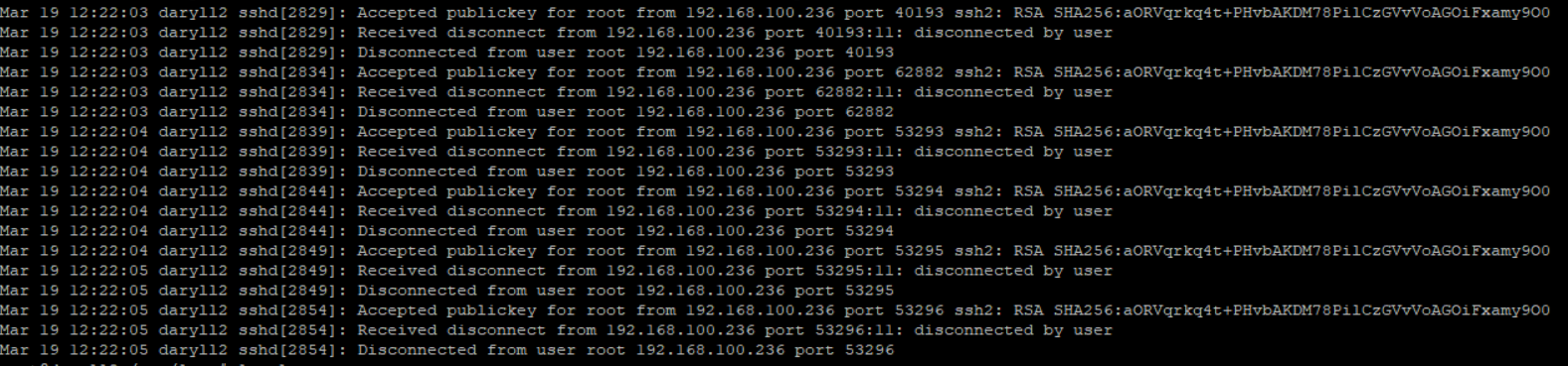

When I setup this task, my only option was module, so that was how it was set. I have since changed the mode to SSH and setup all the required settings and Keys. Authentication does not seem to be an issue and path validation occurs without issue as well. There are no errors in /var/log/messages and it appears that everything is functioning, I am just not seeing the status move past 'starting job' and there is no progress on the sync. I did not ice that the /var/log/auth log shows constant acceptance then disconnects on the destination (PULL) machine. There is not much data out of sync, but the dataset is ~48.1TB. Whenever I get this working I need to sync another dataset that is ~80TB.
Any insight would be much appreciated. Screenshots below.
