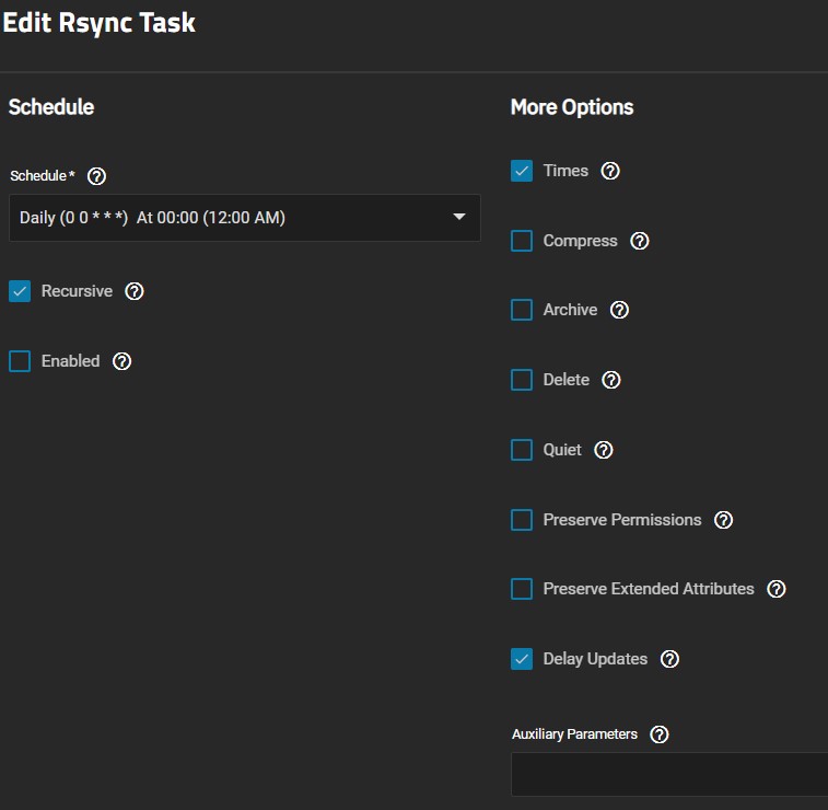

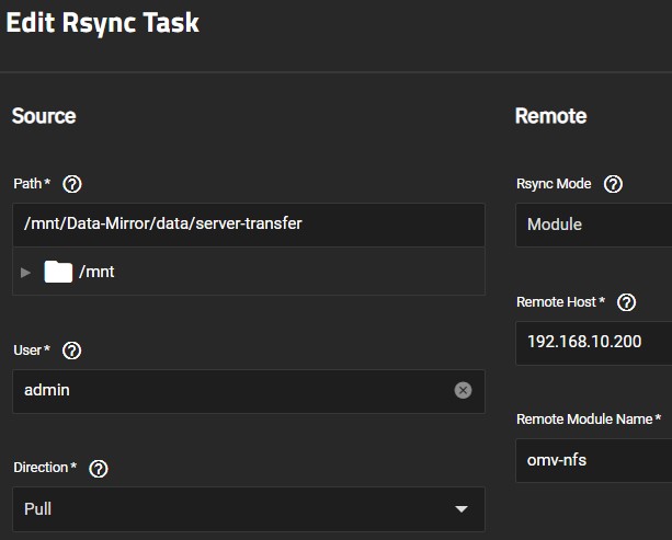

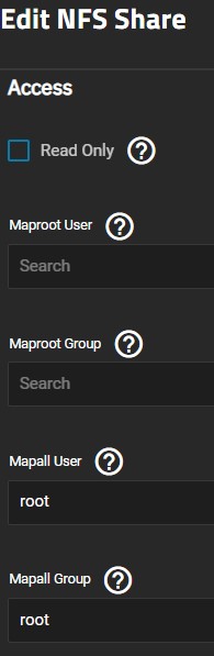

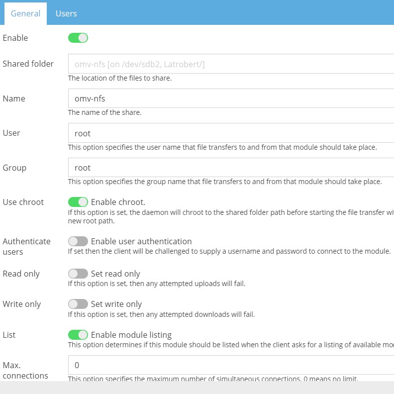

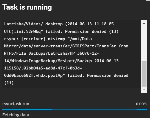

I'm using an Rsync module to copy files from my Open Media Vault server to my Truenas Scale server, without success. My intent is to migrate away from OMV in favor of TrueNAS, so maintaining permissions from OMV files are unnecessary. The main problem seems to be permissions, but I can't figure out how to correct. For my NFS Share on TrueNAS, I thought selecting "root" for Mapall User/Group, but apparently not. Attached is my config, if anyone can help shed some light.
Side-Note:

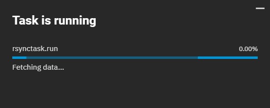

I think the biggest problem is the GUI is very unhelpful when trying to diagnose problems. It shows the job working under the Jobs section in the top-right, never moving beyond 0% with no details. If I navigate to "Datasets" select the dataset, scroll down on right detail pane and click "Manage Rsynch Tasks" then click "running" for the correct task, the same dialogue pops up with no details and stuck at 0%. The only way to see a more detailed log is to select "Data Protection," then under Rsync task click "Running" for the task, which pops up the same dialogue, except now I'm presented with a log.

Why did you enter "admin" for the user? It appears on the OMV side the user is in fact "root".
