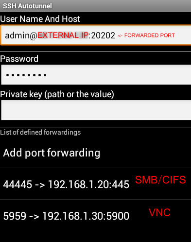

I use "ssh autotunnel" to create a connection to my NAS (3g or wifi), then AntTek Explorer will let you use that tunnel to create an SMB connection that allows my to push and pull files to either my phone or tablet.

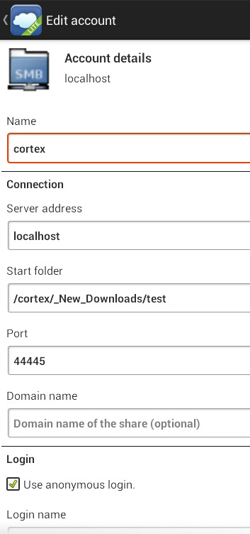

I downloaded it, added an account, which had the SMB/CIFS tunnel info, and I'm doing a sync from my Titanium Backup folder on my SDcard right now. It took a little messing around with the account settings on Foldersync and discovering I needed to create an account with my SMB settings, but it seems pretty smooth and not that hard to setup.
ProtoSD
Jul 1, 2011
3,348
Here are 2 screenshots, one of my SSH Autotunnel settings, the other of the settings for an SMB Account for Foldersync
