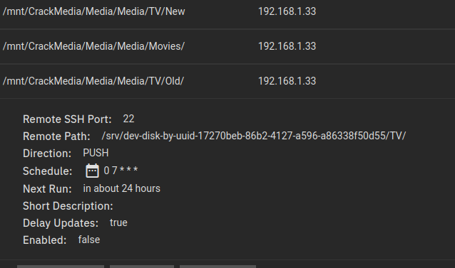

Which of the screenshots is the one you're having issues with? The last one (Old)?
Cyprus125
Jul 18, 2017
24
yes the last one, in command promp can i see what the command and attributes it's doing for these. i'd like to run the command the way the OS is so i can see what is happening.
