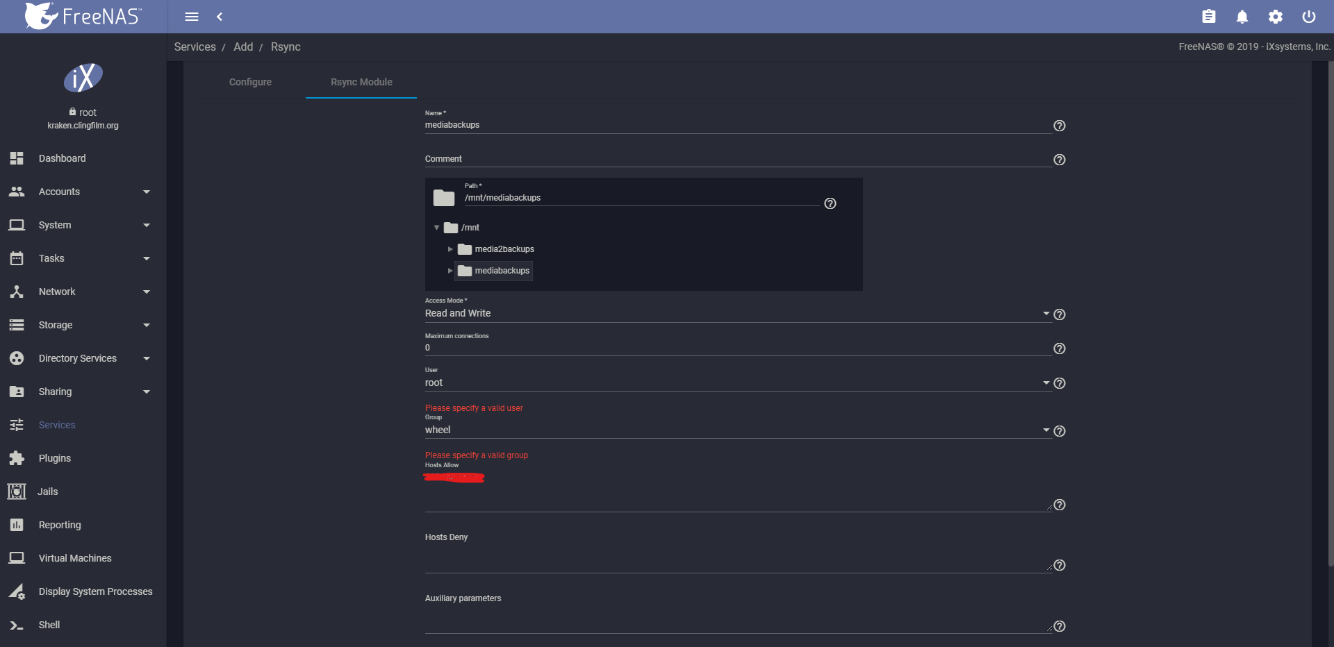

I have recently installed FreeNAS FreeNAS-11.3-BETA1 and am attempting to setup an Rsync module, I was able to create the task on the PUSH server successfully. I am having problems on the PULL server side. I have created a disk pool and data-set, see the attached image. I get the following errors when trying to save the module configuration. I blew out the pool and data-set and tried again, same problem. Is this a BETA1 issue or am I missing something?
Please specify a valid user - as per documentation it is set as root
Please specify a valid group - as per documentation it is set as wheel
Any help would be greatly appreciated :D
thanks!

Good afternoon,
thanks!
That's a bug that made it past QA. It will be fixed in BETA2.

Thanks Chris - interestingly I did try that tutorial before posting as well and it was a no go. I see there was another post after yours from dlavigne mentioning a drop down menu selection bug. At least I'm not going mad! :Do_O
