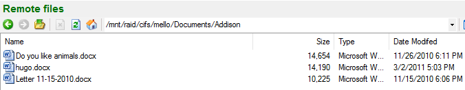

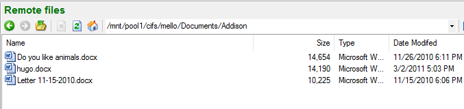

Don't see this here:
rsync files:
Original files:
