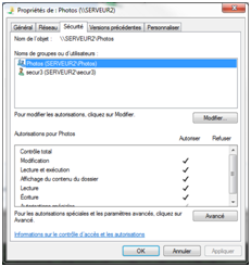

-The share use on folder “Photos” is the same of the other one created on the both server;
-the group “Photos” have aces for ; modification, read/write, show content, read, write, except modify the right of the file ( add new user, group …)
-the user (ownder of the folder) “secur3” have same acces of the group, plus the right for manage the right of the folder ( add user, add group, ... total control)

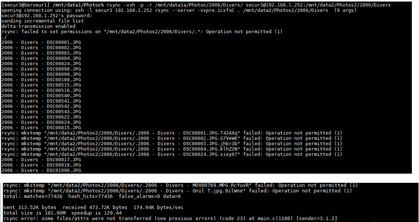

When I launch the RSYNC command line, this is what happen:
On this case I try to sync a sub folder, because is more fast (less data) and I have seme issue with other sub folder.

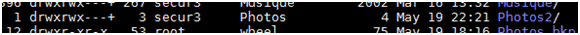

When I verrify on destination on file server (/mnt/data2/Photos/2006/Divers) I have the right for RWX on it for user and group. And is same for the dataset (/mnt/data2/Photos)
Here : Photos2 right on /mnt/data2
Only a part inside of the foler (/mnt/data2/Photos/2006/Divers ) are copied, and is same if I try to (/mnt/data2/Photos), only a part content in this folder are copied…..

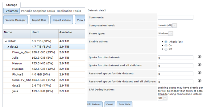

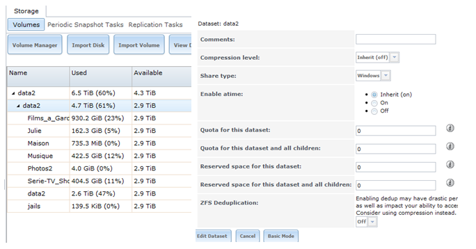

- I delete the dataset “Photos_” (old one) on the freenas server2 and recreate new one with new name “Photos2” to be sure is not a corruption on it. Same issue.
-I change the share type to UNIX (before windows) on the main dataset, Same issue, I return to Windows share type. Sme issue

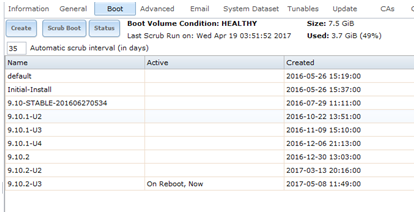

-I rool back on the boot version 9.10.1-U2, … Same issue and come back to 9.10.2-U3...
-I change the command line use with RSYNC with the basic argument : rsync -vvh -p -r /mnt/data1a/Photos/2006/Divers/ secur3@192.168.1.252:/mnt/data2/Photos2/2006/Divers
and more basic : rsync /mnt/data1a/Photos/2006/Divers/ secur3@192.168.1.252:/mnt/data2/Photos2/2006/Divers
Same issue….
