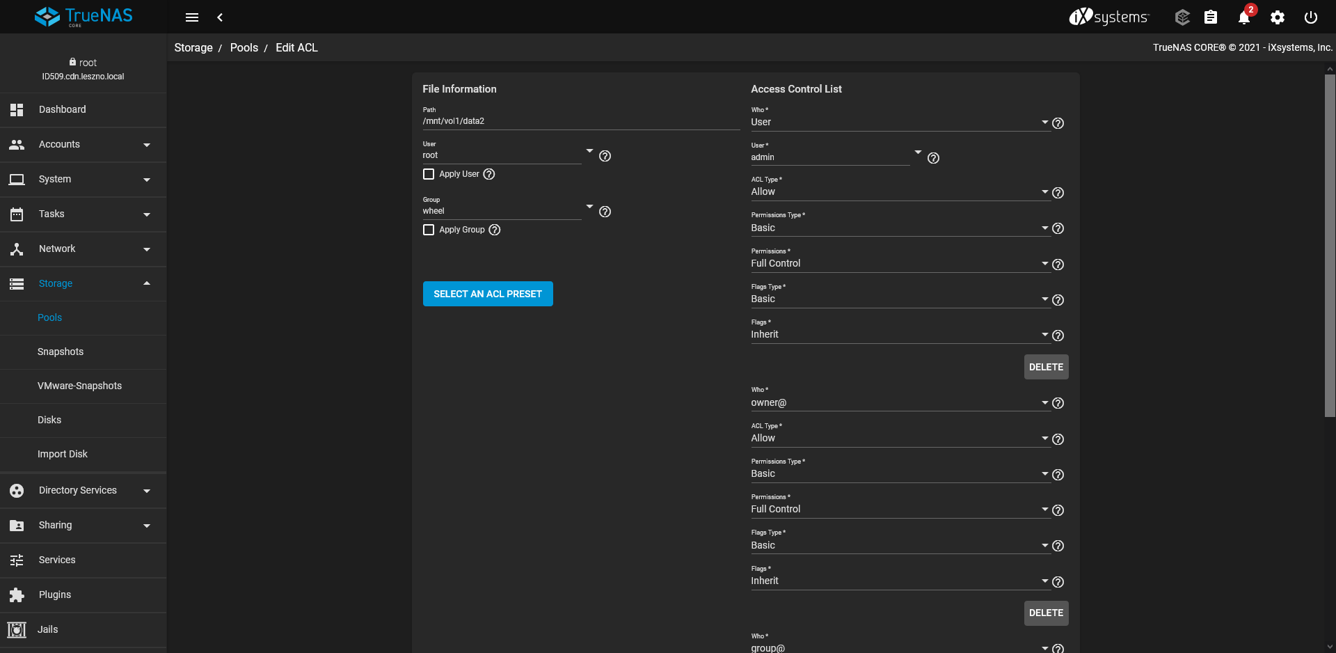

root@ID509:/mnt/vol1 # getfacl data2
# file: data2
# owner: root
# group: wheel
user:admin:rwxpDdaARWcCos:fd-----:allow
owner@:rwxpDdaARWcCos:fd-----:allow
group@:rwxpDdaARWc--s:fd-----:allow
everyone@:--------------:fd-----:allow

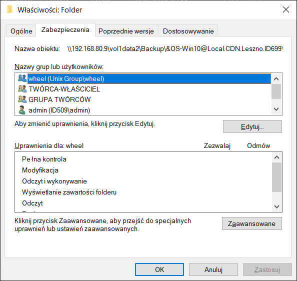

User Admin can create/modife and delete folder/file but can't change permission for file and folder in windows 10.
View my Permission for folder (admin have got full permission)

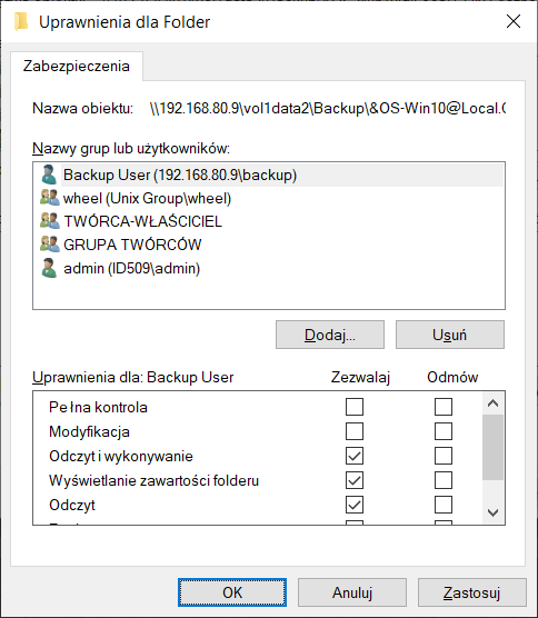

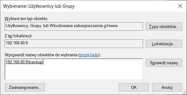

Add another user to folder
Save permission (OK)

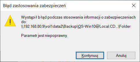

AN error occurred while applying security infromation to:
The Parameter is incorrect

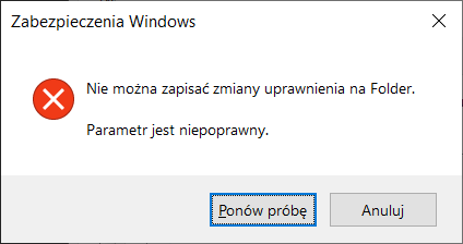

Windows security ---------------------------
Could not save permission change to Folder.
The parameter is invalid.

Last update broken my trueNAS.
I had to fresh install and recovery config. But config does not work. Backup config came from TrueNAS! I will mention that I had FreeNAS 11.x when I upgraded system to TrueNAS (last week).
So I configure manual TrueNas (network,smb and import pool). Now it's work.
Thanks for help.
