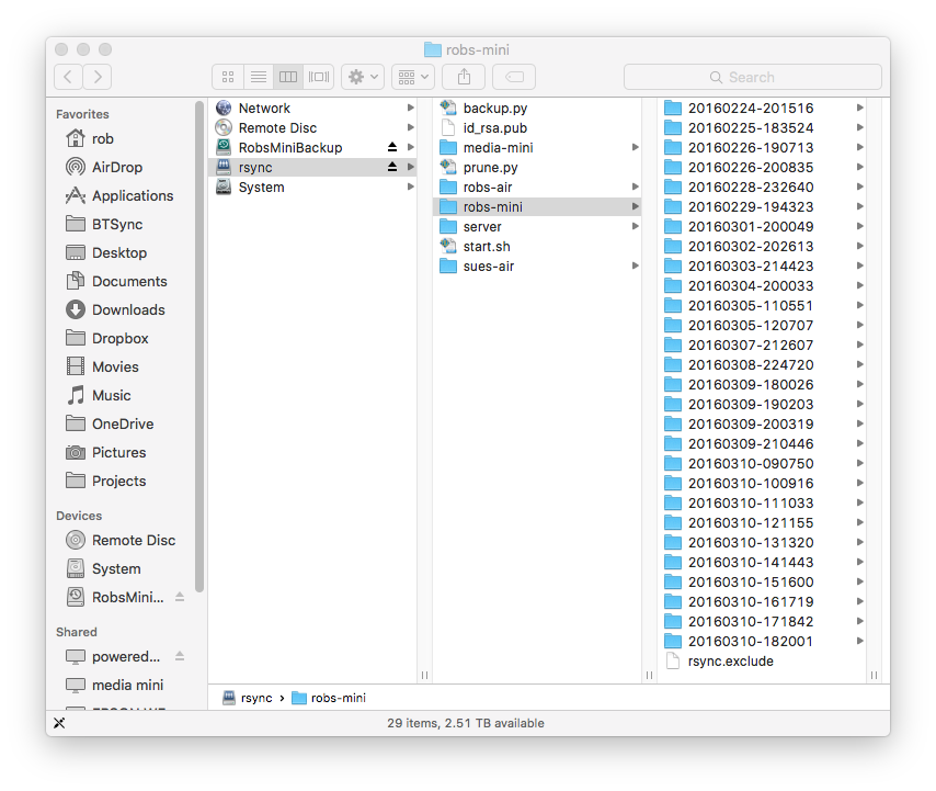

I see a few differences:
  1. There's absolutely no chance mine will start a new rsync while the previous one is still running.
  2. Mine stores each backup in a date- and time-stamped folder.
  3. Mine prunes old backups the same way Time Machine does, as you can see if you study the screenshot closely.
