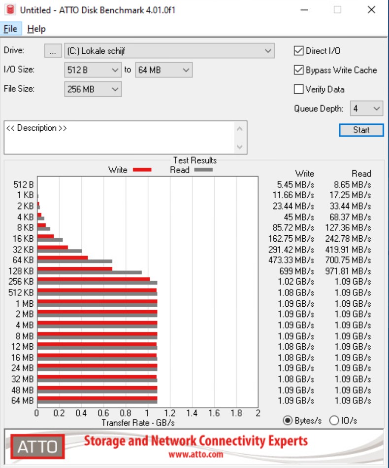

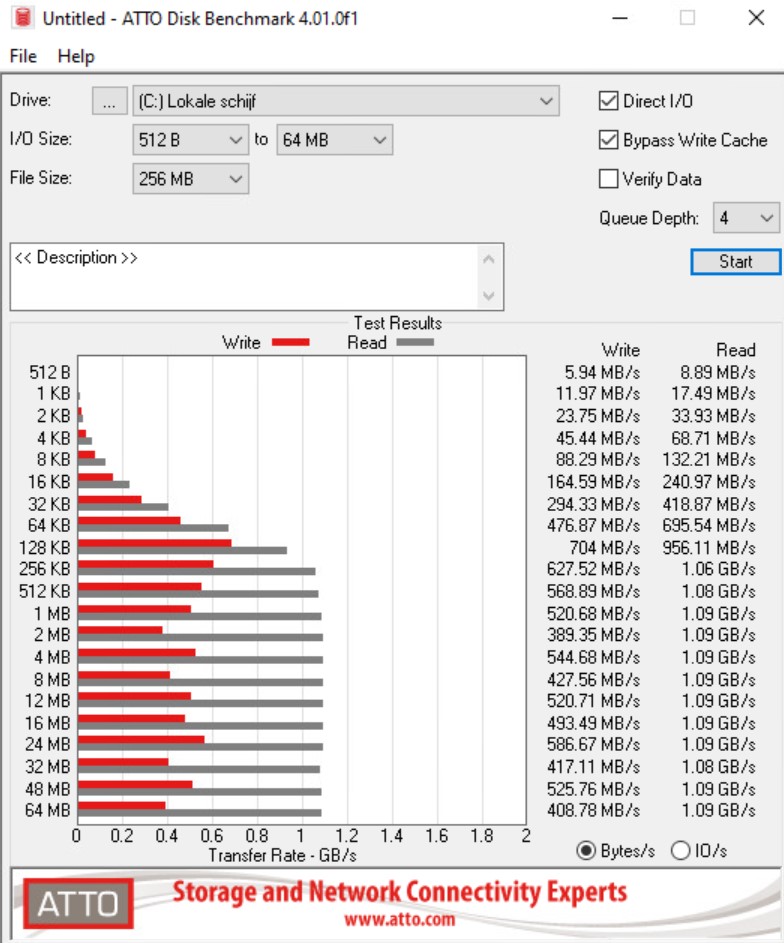

I need some help and understanding why we are getting slow performance with 2x RMS-200 8GB in mirror as a SLOG device to our RAIDZ2 pool (3x VDEVs). As you can see in the attachement, after 128KB @704MB/s write performance it drops and yoyo's up and down.

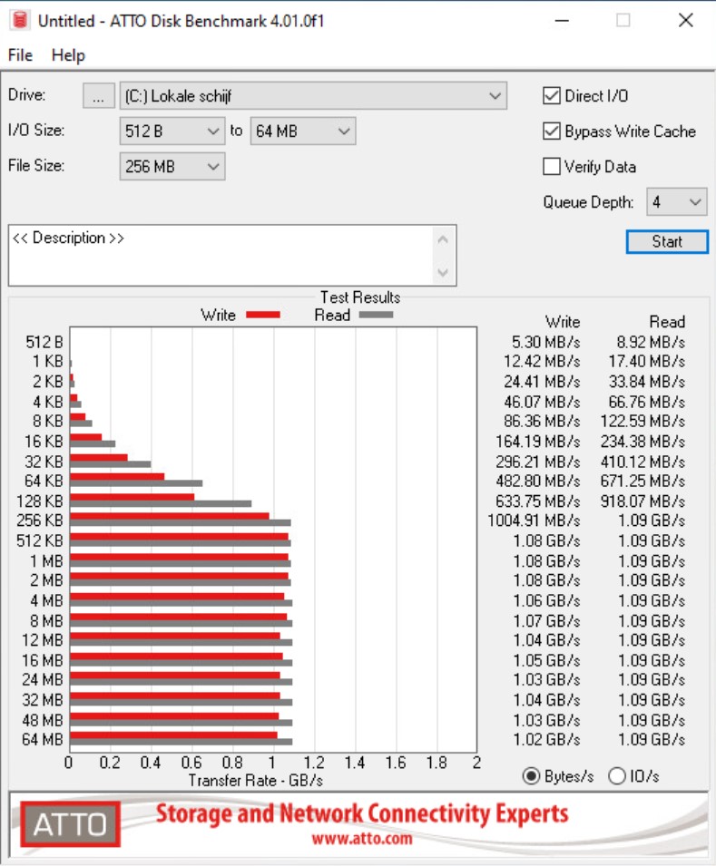

Now when we add these 2x 8GB RMS200 as a stripe device with 16GB SLOG in total, it will max out @1.09GB/s (around max 10Gbps interface) after 128KB. (second attachment)
We also have 2x Samsung nvme DCT 983 1.9T and created 2x 16GB partitions. We added these as a mirror SLOG to the pool and again we get the same maximum performance @1.09GB/s as the 2x RMS-200 in stripe configuration. (no screenshot)
The interesting part is, we created 2x 8GB partitions on the Samsung nvme drives and added these as a mirror SLOG. We get the same performance issue's as the RMS-200 in mirror. So it has to do with the size of the SLOG. And it seems 8GB is just not enough and somehow the system throttles the speed earlier then 60%. But i need to monitor how much is in the transaction group during the test. I tried a dirty data script, but that shows only 260MB in use of the 4GB. So i’m lost…..
We tried tuning dirty_data settings (lowering the transaction group size from 4GB to 3.5 or 2GB), but nothing seem to work. We do get a little bit better performance till 512KB and then the performance dops again.
Also a single RMS-200 gives the same yoyo effect at max 700MB/s.
We also tried changing the VDEV to mirror, but get the performance issue's as a RAIDZ2.

Found the issue. We constantly added the SLOG through the GUI, but we think it creates a 512b cluster size for the SLOG. So we manually created the log partitions on the RMS-200’s and the performance went up to 1.09MB/s. The RMS-200 is a 4k device, so this should work perfectly.
gpart create -s gpt nvd0
gpart create -s gpt nvd1
gpart add -t freebas-zfs -b 2048 -a 4k -l log1 -s 8000M nvd0
gpart add -t freebas-zfs -b 2048 -a 4k -l log2 -s 8000M nvd1
zpool add (poolname) log mirror gpt/log1 gpt/log2
