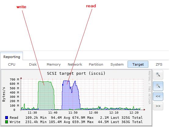

Inspired by quite old post: https://forums.freenas.org/index.php?threads/write-performance-issues-mid-level-zfs-setup.13372/
I decided to make tests of my platform... I have however problem with finding mistake and I would like to ask you for consultation.
Let's start from begining...
My system base on FreeNAS-9.10.1-U4 (ec9a7d3)
It has:
Intel(R) Core(TM) i7-4820K CPU @ 3.70GHz
64GB RAM
9 x NIC (Intel PRO1000 / 1Gbit / 1500 MTU) - 6x DATA chanel working as ISCSI interface to ESXI, 2x BACKUP chanel to another FREENAS system, 1x ADM
RAID10 composed with 9 pairs of disks (all disks are WD RED 3TB 5400 rpm)
Disks of RAID are connected (part of disks through LSI 9260 controler and part of disks via SATA onboard)
There is also L2ARC 120GB SSD bit for all theses tests it was turned off.
Parameters of ZFS are default:
Composition of pool:
Standard system tuning generated by FreeNas automatically.
So...what I did...
First I turned off totally iSCSI and started to check performance (READ) of each of drive by simple DD
I checked each of drive (being part of my pool) and results were more and less the same... 140MB/s max
Of course it is sequentional read.
I compared this with diskinfo:
so.... comparabe... even too much but dd started from data being at the "beining of disk". Data located at the "end of disk" will be probably closer to 70MB/s.
Test base of READ operation (as I cannot damage data) but WRITE operation should be comparable.
OK, anyway.... in FreeNas UI report I see nice, stabile load of each disk.
Next I made the same operation but on all disks (18 disks) in the same time to eliminate eventual interference between disks, interface etc.
So I did:
Result was also as expected... all disk generates the same performance compare to individual tests.
So, physical disk system can transfer up to 140MB/s for each of disk in the same time.
As I have RAID10 (9x2 drives), theoretical performance is:
READ: 18 x read performance of one driver = 2520 MB/s (if I take into account external tracks of disks where performance is 70MB/s it gives me about 1260MB/s for RAID)
WRITE: 9x write performance of one driver = 1260 MB/s (if I take into account external tracks of disks where performance is 70MB/s it gives me about 630MB/s for RAID)
I started to make tests on pool.
First I turned off compression of the pool becasue using dd with /dev/zero (when compression is turn on) gives wrong results.
Second I generated test file (only zeros) with size 107GB... seems large enough compare to ARC size and memory system has.
During genration of file I was checking performance of pool by:
and disk load by
I saw all disk working, each of them (gstat) 99...100 busy.
zpool iostat reports write speed about 890MB/s but not always... sometime it was a little over 170MB/s:
So, there were two issues which I tried to explain:
1.
Why write performance if significantly slower than theoretical (1250 MB/s vs max 890MB/s)... so 29% less than theoretical.
I conclude it is not so bad... even very good - specially if I take into account that my disk on external tracks can have 70MB/s which gives 630MB/s of theorethical write speed
2.
Why write performance is not stabile but flow 170...890MB/s
I conclude it may be result of some ZSF buffer flushing (TXG)
I made tests to detect number of delayed writes compare to not delayed by:
results:
delayed: 89%
not delayed: 11%
I checked also how TXG is filled by:
results were:
All these gives me idea that pool cannot handle such write workload... pool is trying to delay writes hoping that a little later disks will be more free but they are not, so only possibility to flush buffers is to slowdown workload to get some IOPS to do that.
At the end of this part I would like to explain also CPU was loaded max 20% during all these tests.

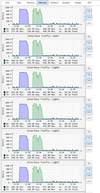

Now time for second part of my test - regarding READ speed.
Traditionally I used dd to read, previously created file (107GB).
I was expecting significant disk load and transfers near 1TB/s.
I used:
Results were a little surprising:
1. disk load (gstat) 30...80%
2. transfer (zpool iostat) from about 300 to 850MB/s
3. dd reported performance as 1025152405 bytes/sec = 977 MB/s
'dd' reported larger transfer (in fact dd was 'client' for ZFS) and it seems I should treat this as real value not data reported by 'zpool iostat'.
'zpool iostat' seems reports transfer to pool but not take into account ARC (am I right ??)
So, 'extra performance' comes from ARC specially on this part of file (107GB) which was cached by ARC.
After this I got idea to turn off PREFECH of zfs hoping that if ZFS will not make read-ahead on not so fast disks I have result should be more stabile.
But after this result was terrible... up to 80MB/s
So, seems I did not understand correctly how prefetch is working (can you explain ??)
In this part of test READ speed and specially fluctuation 300...850MB/s is for me the biggest surprise.
During all these tests CPU load not exceed 20% also.
So, sorry for long introducion to ask final questions...
1. Do you think above tests as reasonable ? Do you see mistakes in philosophy of these tests and/or interpretation of results ?
2. Do you agree, WRITE performance cannot be better without chaning hardware / adding more disks to RAID ?
3. How to find bottleneck during READ operation causing fluctuation ? Is it possible to dtrace stages of ZFS during reading data ?
