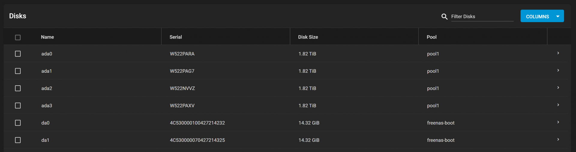

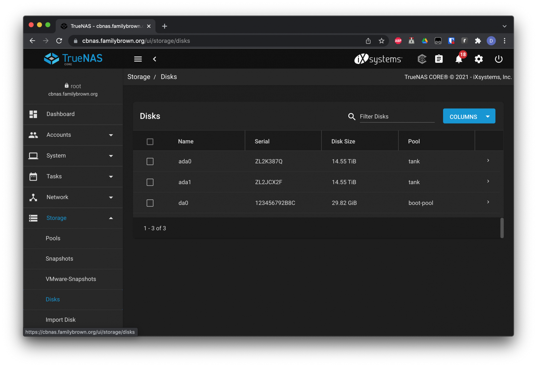

1) Identify and remove one disk at a time from the pool beginning with the failing disk
The Storage -> Disks page will show the serials of each disk:
So if ada0 is the one showing errors, first offline ada0, then go to this page and note its serial number. Power down the server, find the disk with the corresponding serial number, remove it, and replace with its replacement. Boot the server, and replace the disk through the GUI. All as described in the docs:
