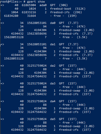

If that does not work, a gpart resize might be necessary, first. Please post the output of gpart show in that case.
No that didn't work. The command zpool online -e ... reports ok but nothing happens.
Here are the screen dump from gpart show da2-da5 is in pool main RAIDZ2

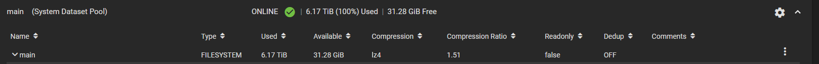

Any suggestion because the GUI still says 100% used. Do I have to rebuild the RAIDZ2 and copy from backup?
9,703
zpool list is showing that it's actually fine, it's just the GUI that hasn't caught up with what's going on...

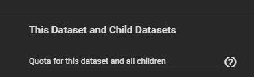

I finally find out that there was a quota set 6.2TB on the pool Dataset main done by the guy who did the configuration which wasn't me :rolleyes:
Thanks for all help and suggestions :grin:
