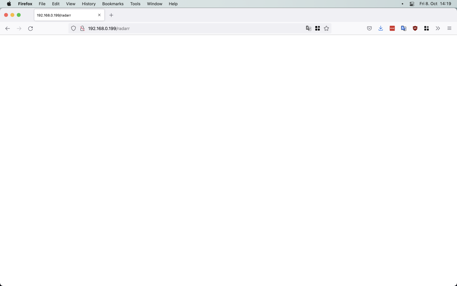

This isn't. Is there anything in the page or tab heading (i.e., where the page name would normally appear), or is it completely blank?
Electr0
Dec 18, 2020
47
Just the address that I'm trying to navigate too.
I tried giving my Sonarr jail a static external IP and updating the Caddyfile with it, but even that didn't work.

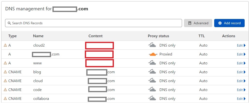

NasKar
Jan 8, 2016
739
My reverse proxy stopped working. Don't know what the issue is. iPhone on cellular Safari say to many redirects. Works fine on my local network with the lock symbol.
Setup:
TrueNAS 12.0-U8
iocage jail caddy 192.168.5.83 (reverse proxy with this script)
iocage jail cloud 192.168.5.81(nextcloud)
iocage jail wordpress 192.168.5.235
VM collabora 192.168.5.89
Namecheap for mydomain has the cloudflare DNS
Cloudflare DNS settings unchanged since RP was working. Red is WAN IP and Grey box is mydomain.
When on an outside computer to my network and I ping cloud.mydomain.com I get request time out but my WAN IP shows up.
I reinstalled the RP jail (probably shouldn't have done that) but not love. Hope someone can point me in the right direction. Thanks
Caddy file with my domain replaced with 'mydomain'
