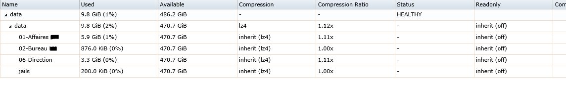

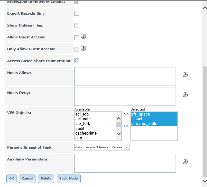

Hi there,
I did a setup of freenas and all is good except that I configured snapshots (like this or like this) and I can browse previous versions, but I am unable to restore files or copy them to other location, it says file is invalid or filename too long, but the length should not be the issue since I tried with mapped drive and it's less than 255 car.
My setup is as is :
1 : is the volumes setup
2 : is the snapshot setup
3-4 : is share setup
Any idea about what is wrong ?

Check the files to see if they contain alternate datastreams. From the FreeNAS cli cd /mnt/<pool>/path/to/share then lsextattr user *. If you see xattrs with the prefix "DosStream", then those files won't be able to be restored via previous versions over SMB2. The samba project is looking at a possible ABI change to make this work (not an easy fix). https://bugzilla.samba.org/show_bug.cgi?id=13455
One workaround I do is to expose the zfs snapdir over SMB. Add the share auxiliary parameter zfsacl:expose_snapdir=true, and the share auxiliary parameter veto files = /.windows/.mac/
Once you add those parameters, restart samba, log out and log back in on your windows client, then navigate to
\\server\share\.zfs\snapshot\
You have to paste the full path into explorer unless you choose to set the zfs dataset property "snapdir=visible" from the CLI.
This is working properly in 11.1-U5, but possibly not earlier versions.
