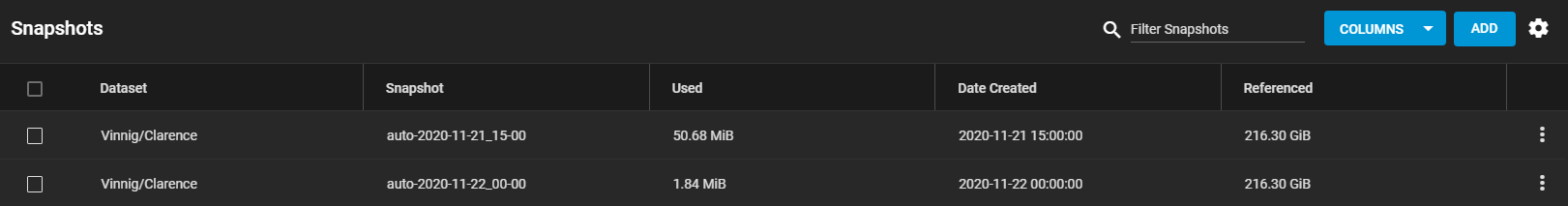

SMB Share with "Default share parameters" for dataset "Vinnig/Clarence" → shadow copy enabled
Periodic snapshot setup, creation of one, SMB service restart.

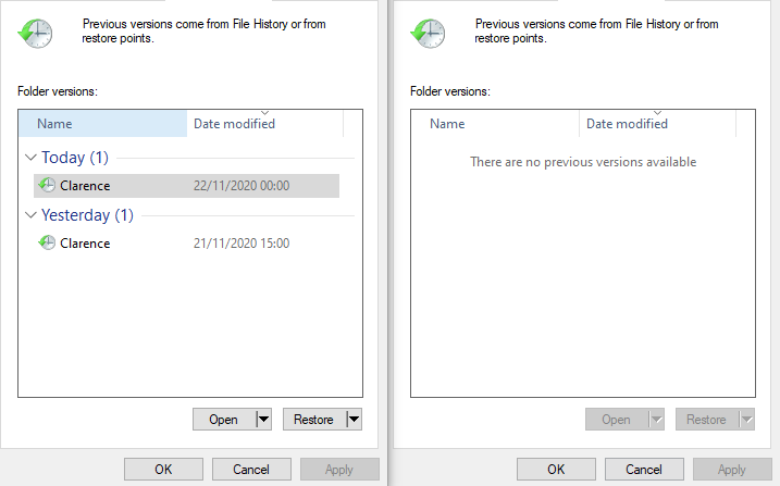

Result:
Most of the time the previous versions tab in windows explorer only populates when I connect to the share via the IP address and NOT the hostname.
Sometimes after an SMB service restart or the removal and subsequent re-adding of "enable shadow copy" the snapshots would appear for a time in the "hostname" previous versions tab but then disappear shortly thereafter.
If I make the .zfs snapshot directory visible, I can navigate to and use it properly via the "hostname".
Does anyone else find this super weird?!?
