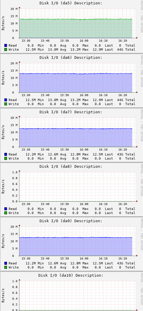

What I am observing is that the drives in the other 2 VDEVs are also reading at the same data rate as the one in the "expected" VDEV.
I should explain that I'm building up a new zpool and have deliberately taken one drive in each mirrored VDEV offline during the initial seed copy as the copy speed seemed to be unreasonably slow to me initially and it improved about 30% when I essentially moved back to a stripe of 3 drives (3 single-disk VDEVs) to take the file copy. Now the copy is over, I am putting back the first drive in Mirror-0, but I see in the reporting that the other Mirrors are also reading at exactly the same speed.
Can anybody confirm that they have seen this? (I guess in any case of resilvering in a grouping of mirrored VDEVs)
Can anyone explain why it's happening? (how can it be useful or "by-design" to read data that has nothing to do with the target of the resilver?)
What I see:
ZpoolX
Mirror-0 Disk1 reading at about 13 MB/s
Mirror-0 Disk2 writing at about 13 MB/s
Mirror-1 Disk1 reading at about 13 MB/s
Mirror-1 Disk2 (still offline, but I assume would also be reading)
Mirror-2 Disk1 reading at about 13 MB/s
Mirror-2 Disk2 (still offline, but I assume would also be reading)

Reports of disk activity as you can see even from the thumbnail below. (first disk resilvering, 3 others reading, 2 offline)

I think this is normal behavior. A resilver and scrub use the same code.
Even though you have a mirror, ZFS does not just image one drive to the other. Using the scrub code, it walks the entire metadata tree and then replicates blocks it finds in that mirror to the other disk. It would seem like a logical optimization to not bother reading the other blocks, but as I said, a resilver is a scrub. So, you get two for one, and put your next scrub farther into the future.
9,702
Perfect explanation! Thanks for the information, it makes sense (at least as to why it happens if not actually that it happens as per your comment).

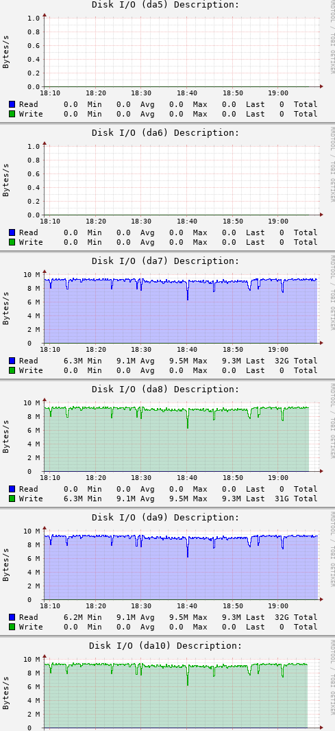

As a PS to the thread, some more unexpected outcomes when I onlined the other 2 disks:
This time, the first VDEV remains inactive while the other 2 VDEVS are resilvering (at about 9MB/s... slower than when I did the first one).
