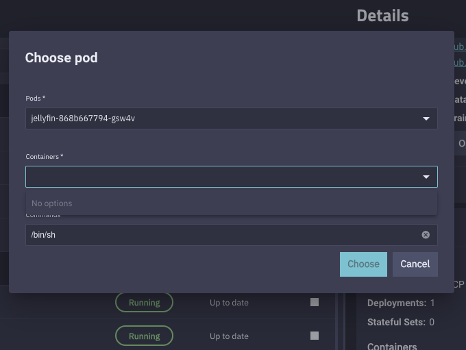

this what i get when i attempt to

You have probably more than one option in that first item... check each of those for the running container in the second box.
9,700
Your screenshot shows no options in the second drop-down... what about the first one above it?

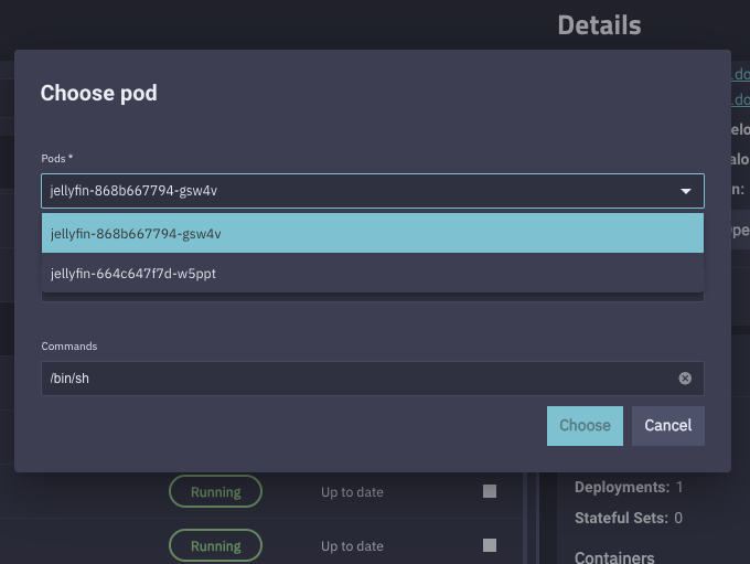

thats the top one u talked about yes there is another option, and no my container is not stopped
9,700
You need to select one of those (or all of them in sequence) until you find the one that has a second option for you.

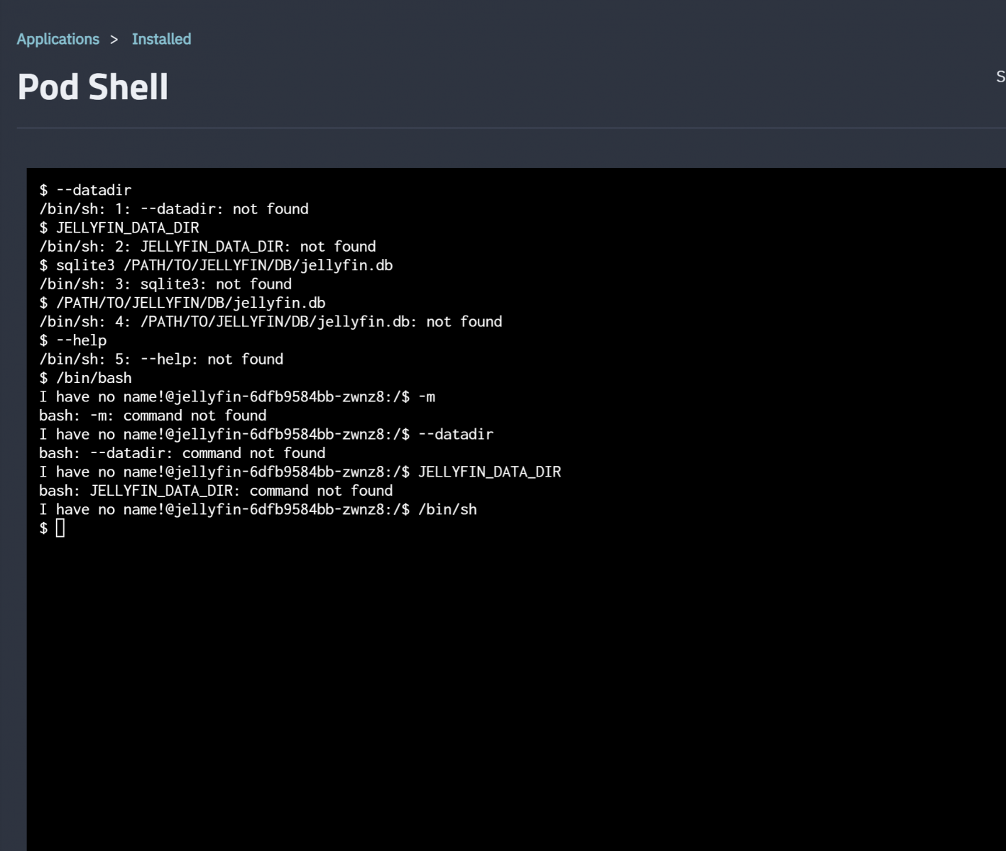

i got into the shell of jellyfin, but i'm having issues with the commands, i tried the ones you gave me i know they should work. I can admit it's all user error.
9,700
OK, so that screenshot tells me you don't really know what you're doing...
What you should do is type this in the shell:
find / -name system.xml
That should come back with one or more locations of the file, possibly /etc/jellyfin/system.xml (but maybe different to that, which is why we start with the find command).
Once you know that file location, you would edit that file to replace <IsStartupWizardCompleted>true</IsStartupWizardCompleted> with <IsStartupWizardCompleted>false</IsStartupWizardCompleted>
The problem we may have is that there may be no editor installed in that container, so depending on the prescence of nano, vi, vim in the container, we may even need to resort to cat.
let's simplify that once you find that file.
Then you would stop and start the app, which should go back through the initial setup, including the admin account password setup.
