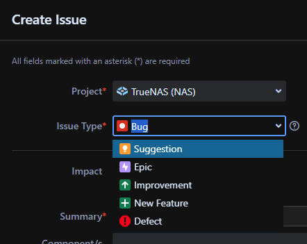

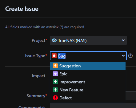

Improvement/Feature requests are made on Jira through the Report a Bug link on the masthead. Log in and use the create link to select your option.
