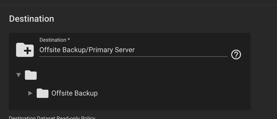

Before running the task

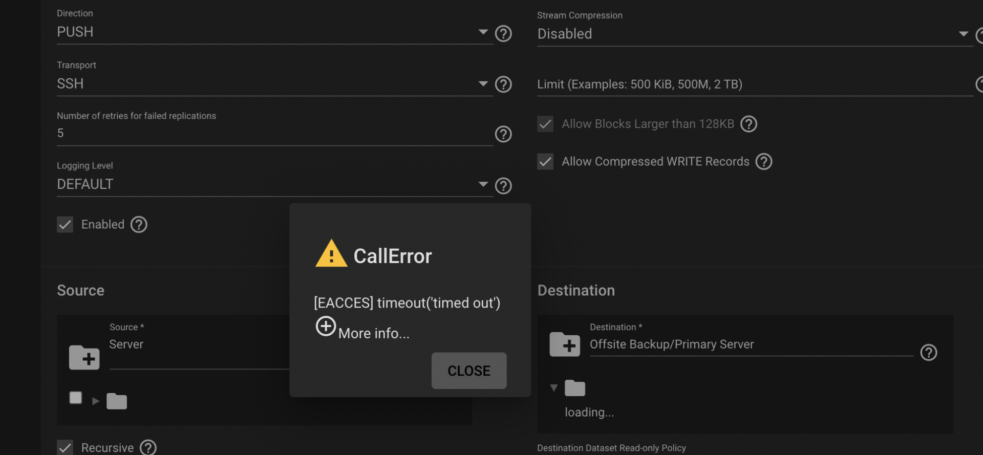

2 Seconds after running the task

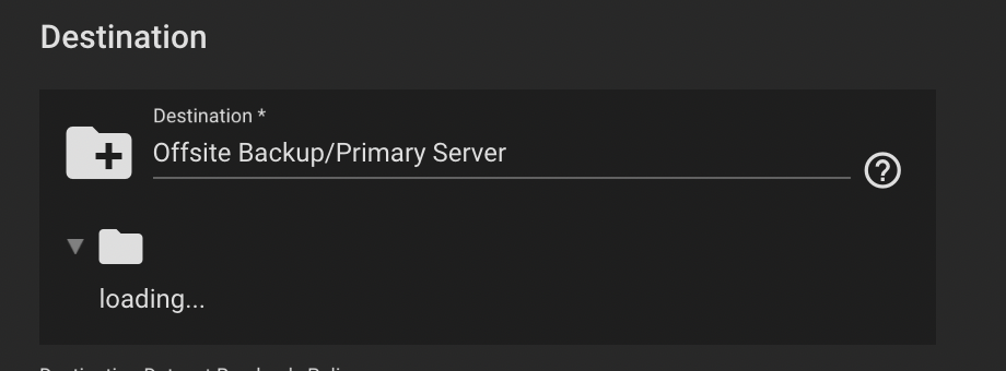

and then this after about 10 seconds, then i will have to wait about 10 - 15 minutes for it to look like the first screenshot
