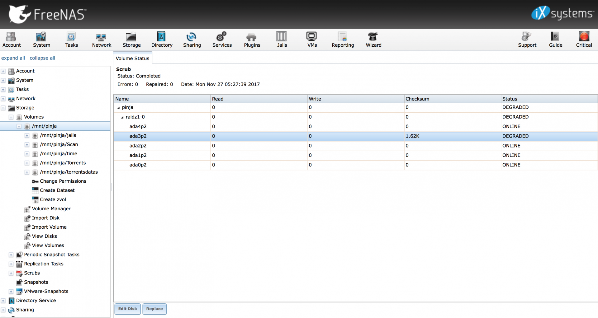

Thank you for yours help. What did I miss, that I can not select offline the degraded hdd. I am sure it is ada3, but offline bottom is missing when I select ada3. On all other drives I can select offline, but of course I did not do it because they are working just fine.

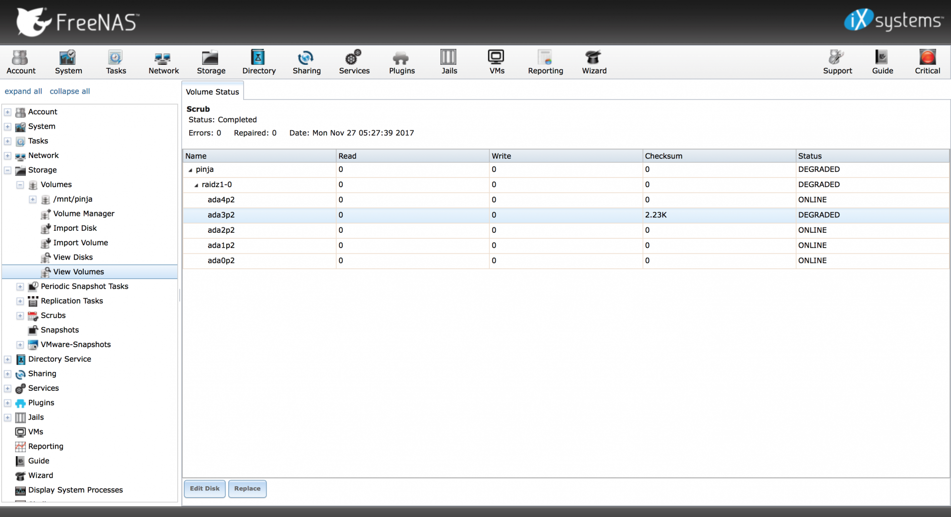

That is not in the correct place. I may have missed a step in the description. Down that list on the left where it says 'View Volumes', click that.
Storage
> Volumes
> > View Volumes
Inside there is where the steps I gave you should start.
Chris Moore
May 2, 2015
10,079
It should look like this.
I think you will need to shutdown the NAS and clear the drive on another system, then put it back in and boot the NAS. At that point, it should let you replace the drive.
