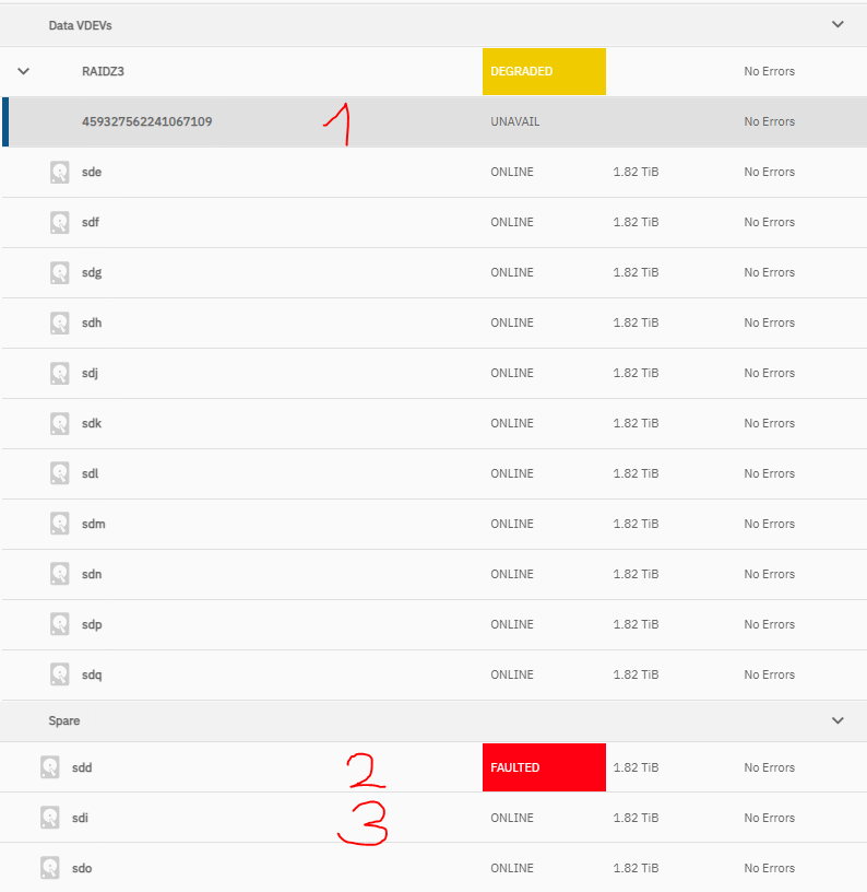

hubacekp2
Jan 5, 2024
6
zpool replace <pool> <bad device> <good device>
ex: zpool replace tank /dev/sdb /dev/sdc
Excelent. Thank you. I will test it after I find out how to solve my HDD is quoted missing.
Does anyone has idea how to:
- replace missing HDD N°1 ?
- remove or cancel hot spare N°2 ?
- can I easily replace the HDD N°1 by N°3 ?

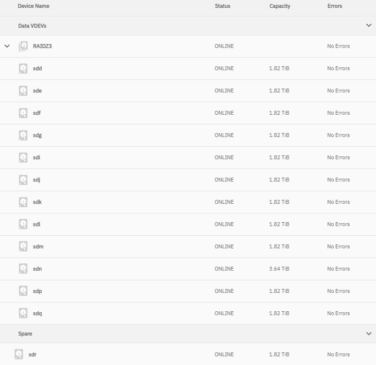

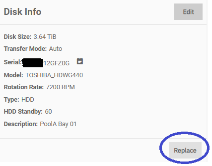

I'll describe what I have done as it may be usefull for others:
1) Replacement of unavail HDD by another HDD of the same size in GUI was not possible - showed me the HDD must be larger size
I didn't figure out how to replace 2TB unavail HDD by any of my 3pcs of 2TB HDD.
So I decided to buy a new 4TB HDD for the replacement in the GUI and resilvering was done with charm.
2) Remove FAULTY HDD
I typed the following commands in the shell:
zpool status PoolA
=> this printed me the list of my HDDs with exact device name.
note: Interesting is, that HDD sdd in GUI is sdd1 in command line
zpool remove PoolA /dev/sdd1
=> this removed my FAULTY spare HDD sdd within 5 sec
3) Remove healthy HDD
zpool remove PoolA /dev/sdi1
=> this removed my other spare HDD sdi within 5 sec.
note: This HDD sdi is healthy so I can use it elsewhere.
The present result:
My toughts:
As my Zpool is raidz3, I prefer to have cold spare instead hot spare.
This will save the life of my HDD and I replace the HDD only on "email request when TrueNAS allert me".
I'll proceed to replacing the 4TB hdd by 2TB hdd and see, if I succeed in GUI.
Eventualy, I am ok with the posibility I don't succeed the replacement to have back all the hdds of the same size in the pool.

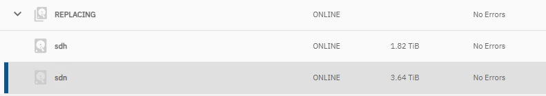

hubacekp2
Jan 5, 2024
6
Surprisingly, I have suceeded, in GUI, to use the command "Replace" for the sdn HDD 4TB and replace it by previously removed sdi HDD 2TB used as hot spare HDD. Now resilvering.
Only one a bit onnoying thing in TrueNAS GUI is, that device name changes every time when I do a change add/detach/replace/remove and HDD. I would prefer to have the name fixed with HDD serial number. Not sdh only, but informative like sdh_2GFZ0G (6 last letters from hdd SN). Well, just dreaming.
