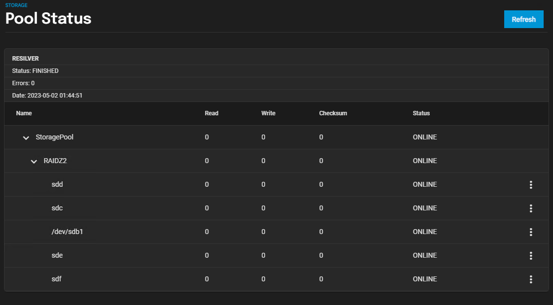

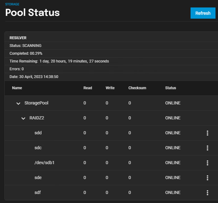

It started the resilvering process without issue
This means the larger partition would be smaller than the other pool member partitions, so i imagine the resilver will fail near 100% (currently at 81% - 6 hours to go).

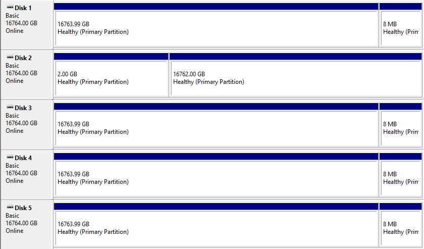

The RMA drive is Disk /dev/sdc (disk 2 in windows screenshot)

[B]Disk /dev/sdc:[/B] 16.37 TiB, 18000207937536 bytes, 35156656128 sectors
Disk model: VMware Virtual S
Units: sectors of 1 * 512 = 512 bytes
Sector size (logical/physical): 512 bytes / 512 bytes
I/O size (minimum/optimal): 512 bytes / 512 bytes
Disklabel type: gpt
Disk identifier: D6F9D8A4-5383-4C84-AA23-C2147ADE4674
Device Start End Sectors Size Type
[B]/dev/sdc1 128 4194304 4194177 2G Linux swap[/B]
/dev/sdc2 4194432 35156656094 35152461663 16.4T Solaris /usr & Apple ZFS
