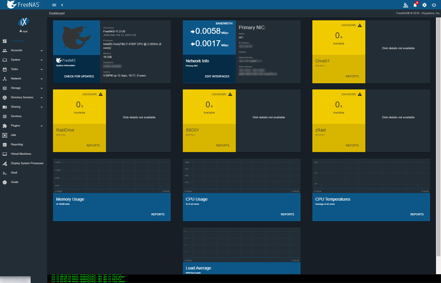

fakebenwhite
Mar 3, 2019
8
Download the config, buy a cheap 128 GB SSD and install FreeNAS on it, load the config
So I had a similar issue to OP, and I ended up doing what is recommended here, but when I get back into the UI, all my drive pools are in an "unknown" status, and nothing looks to be configured besides the user accounts.... Am I missing a step or is something missing from the config file?
Update: This appears - at least partially - to be an issue related to system version, as a "zpool import" was telling me the disks were damaged, but there was a note about unavailable features or something of the sort, so I figured I must have an older version loaded...
I've reinstalled with 11.3-U2.1 (previous attempt was 11.2-U8) and the errors are gone, but so are all the drive pools. However, "zpool import" shows the pools available for import by using the "-f" flag.. But I'm not ready to take that step yet.
Final Update: Looks like the first attempt at restoring the saved config failed, and that's why the pools were missing. After a second attempt at the config upload, everything appears to be mostly normal.. Maybe this will help someone else.
