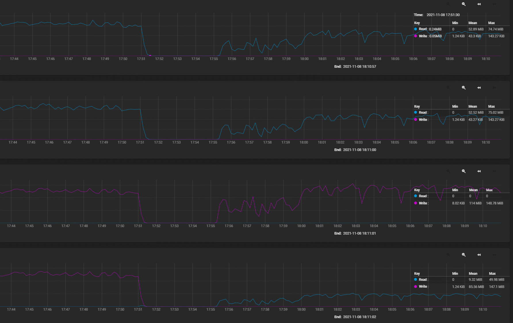

I did a test using two spare disks, I have added the two disks (extend) to the existing mirror vdev.
It started resilvering. I noticed reads from both existing drives and writes to the two new drives. However, after finishing the resilvering it started again with resilvering just a single (3th) disk?
This is quite unexpected.
I have added a screenshot from the read/write speeds.
The first two drives are the original two disks in the mirror vdev that is being extended.
It finished resilvering and then started resilvering the 3th drive.
Can someone explain what is going on here? I did not expect this to happen.
