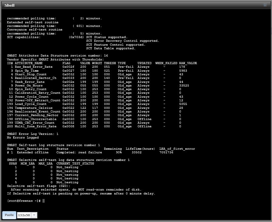

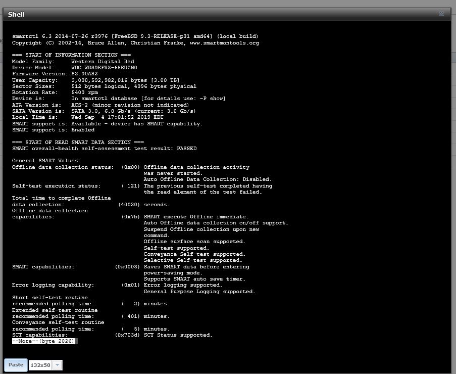

A few days ago I heard some off sounds coming from my NAS box which is under my desk. Thankfully not the "click of death" but certainly sounded like it was trying to re-read the same area of a drive. Having all sorts of drives fail over the years I knew this wasn't a good sound. Opening up the console I see a fairly ominous "Device: /dev/ada2, 1 Current unreadable (pending) sectors" message.
I ran a long test of the drive (attached) and sure enough it is on it's way out. I'm not an expert in analyzing SMART results, but I don't see any good news in there other than maybe "(90% remaining). "

I am assuming it is still ONLINE because even though it is having some read errors the disk hasn't completely died (yet).
Correct, in fact ZFS won't necessarily report a pool as degraded if there exist certain issues with the SMART results. I've replaced and RMA'ed disks which ZFS didn't mark as degraded but that nonetheless has troubling SMART test values.
