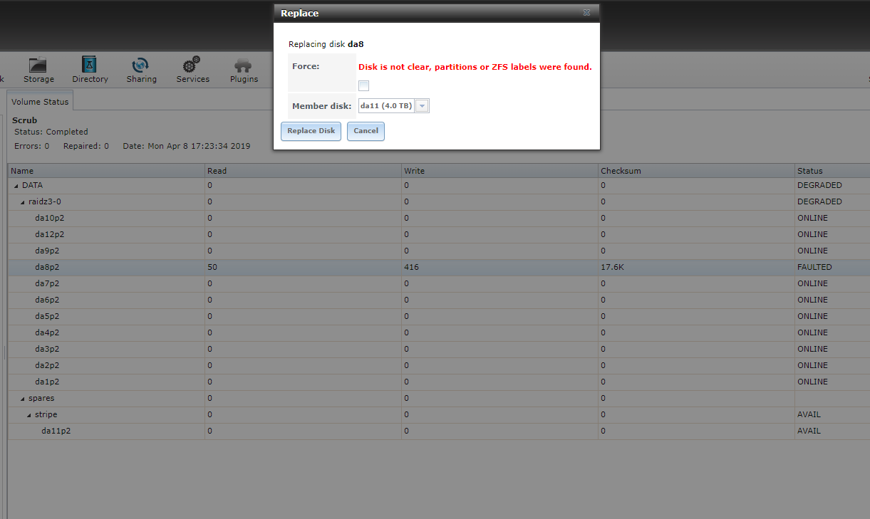

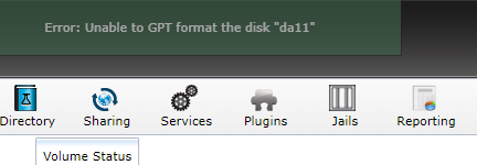

Hello again, i tried replace hd but receive the message below to force.
is there any reason to dont do that? or another way to replace.

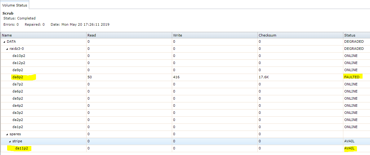

zpool status
[root@nasbkp01] ~# zpool status
pool: DATA
state: DEGRADED
status: One or more devices are faulted in response to persistent errors.
Sufficient replicas exist for the pool to continue functioning in a
degraded state.
action: Replace the faulted device, or use 'zpool clear' to mark the device
repaired.
scan: scrub repaired 0 in 41h23m with 0 errors on Mon Apr 8 17:23:34 2019
config:
NAME STATE READ WRITE CKSUM
DATA DEGRADED 0 0 0
raidz3-0 DEGRADED 0 0 0
gptid/f92e0fff-56c7-11e7-8ab3-d89d67230870 ONLINE 0 0 0
gptid/f9ea1d11-56c7-11e7-8ab3-d89d67230870 ONLINE 0 0 0
gptid/fab4857c-56c7-11e7-8ab3-d89d67230870 ONLINE 0 0 0
gptid/fb754095-56c7-11e7-8ab3-d89d67230870 ONLINE 0 0 0
gptid/fc4b77ce-56c7-11e7-8ab3-d89d67230870 ONLINE 0 0 0
gptid/fd049811-56c7-11e7-8ab3-d89d67230870 ONLINE 0 0 0
gptid/fdc797da-56c7-11e7-8ab3-d89d67230870 ONLINE 0 0 0
gptid/fe87b2af-56c7-11e7-8ab3-d89d67230870 FAULTED 50 416 17.6K too many errors
gptid/ff52cf0e-56c7-11e7-8ab3-d89d67230870 ONLINE 0 0 0
gptid/006b8c5f-56c8-11e7-8ab3-d89d67230870 ONLINE 0 0 0
gptid/015a138f-56c8-11e7-8ab3-d89d67230870 ONLINE 0 0 0
spares
gptid/024f1cc8-56c8-11e7-8ab3-d89d67230870 AVAIL
errors: No known data errors
pool: freenas-boot
state: ONLINE
scan: scrub repaired 0 in 0h0m with 0 errors on Sun May 12 03:45:43 2019
config:
freenas-boot ONLINE 0 0 0
da0p2 ONLINE 0 0 0

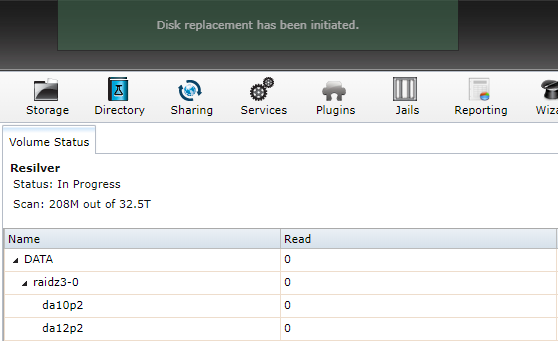

forbyd
Mar 18, 2019
21

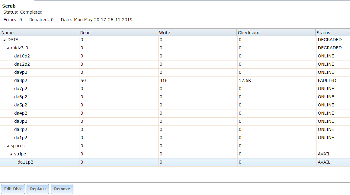

I tried replace da8 to da11(spare), the same pool i guess (can u see in the first print).. I not expert in the freenas yet :/
Thank you for the fast reply.

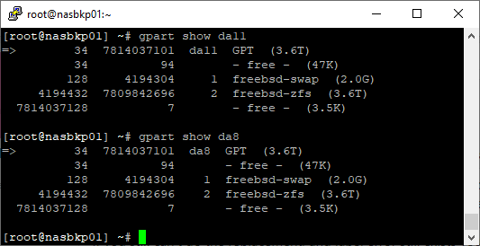

zperetz
Dec 2, 2017
36
Looks like you are trying to replace the "bad" disk with another "new" one, which was already used before in another (or the same) pool.
If so, you need to remove the label of this old pool from your "new" disk (wipe with dd or zpool labelclear) before choosing it as a replacement.
forbyd
Mar 18, 2019
21

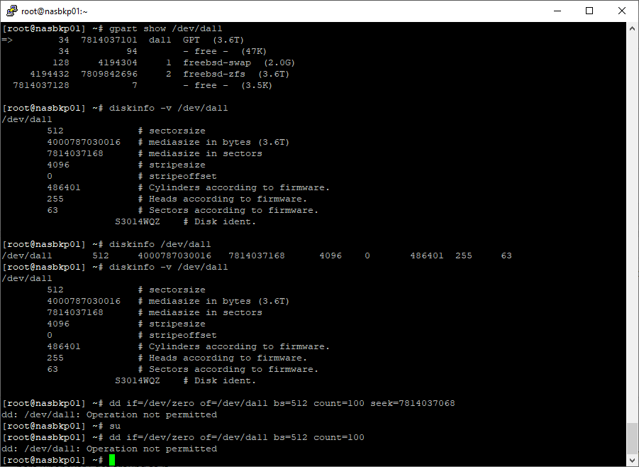

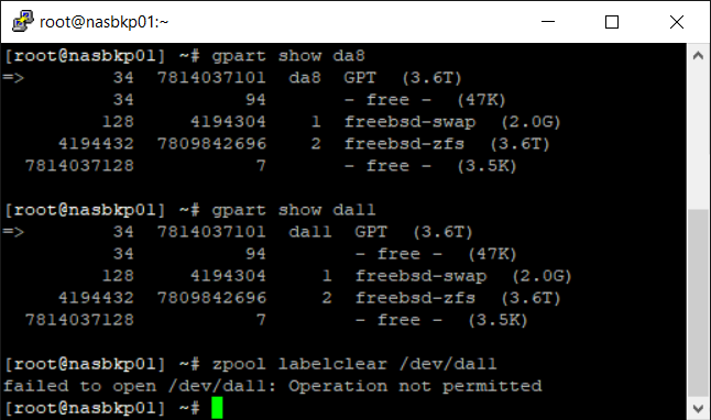

Yes, i trying replace da8 (faulted) with da11 (spare disk)
Need I zpool labelclear in the spare disk?
the command is: zpool labelclear /dev/da11 ?
sorry about my poor knowledge. The guy who ran freenas, left the company.
zperetz
Dec 2, 2017
36
You need to clear all partitions from disk and do labelclear, according to the error you have.
gpart show da11 should not list any unexpected partitions. If there are any, you can do gpart destroy -F da11 to clear the disk and check again.
If you still can't do the replacement, and label error still exists you need to zpool labelclear /dev/da11.
ethereal
Sep 10, 2012
762

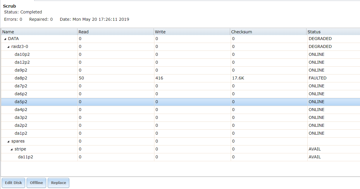

Did you put the disk to OFFLINE status before (via GUI)?
they said to offline the disc so you can wipe it - you need to offline da11 - because you need to wipe it before you can replace the faulted disc but you are trying to offline da8 the wrong disc.
do you have another computer ? in the past i have used another computer to wipe the discs. then you'll be able to replace da8.
you should be able as it is the spare to just shutdown freenas and remove da11 - it is a spare after all that is not being used
zperetz
Dec 2, 2017
36
I can't, don't show the option:
da11: (show "Edit Disk" "Replace" "Remove")
As it's a spare, you should be able to remove it from the volume without any damage to the pool. I think you can try to apply "Remove" button to da11 and then you will be able to "Replace" da8 with da11 even without wiping. I'm not sure, but you can try.
ethereal
Sep 10, 2012
762

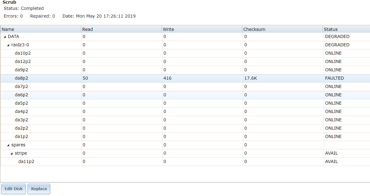

it looked to me he was trying to offline da8 instead of da11 (we know he needs to offline da11 so he can wipe it)
yessssssssssssssssssssssssssssssssssssssssssssssssssss
I removed the da11 and try replace da8 again into the da11, and show this message:
Thanks youuuuuuuuuuuuuuu
if all work I will back here to say.
