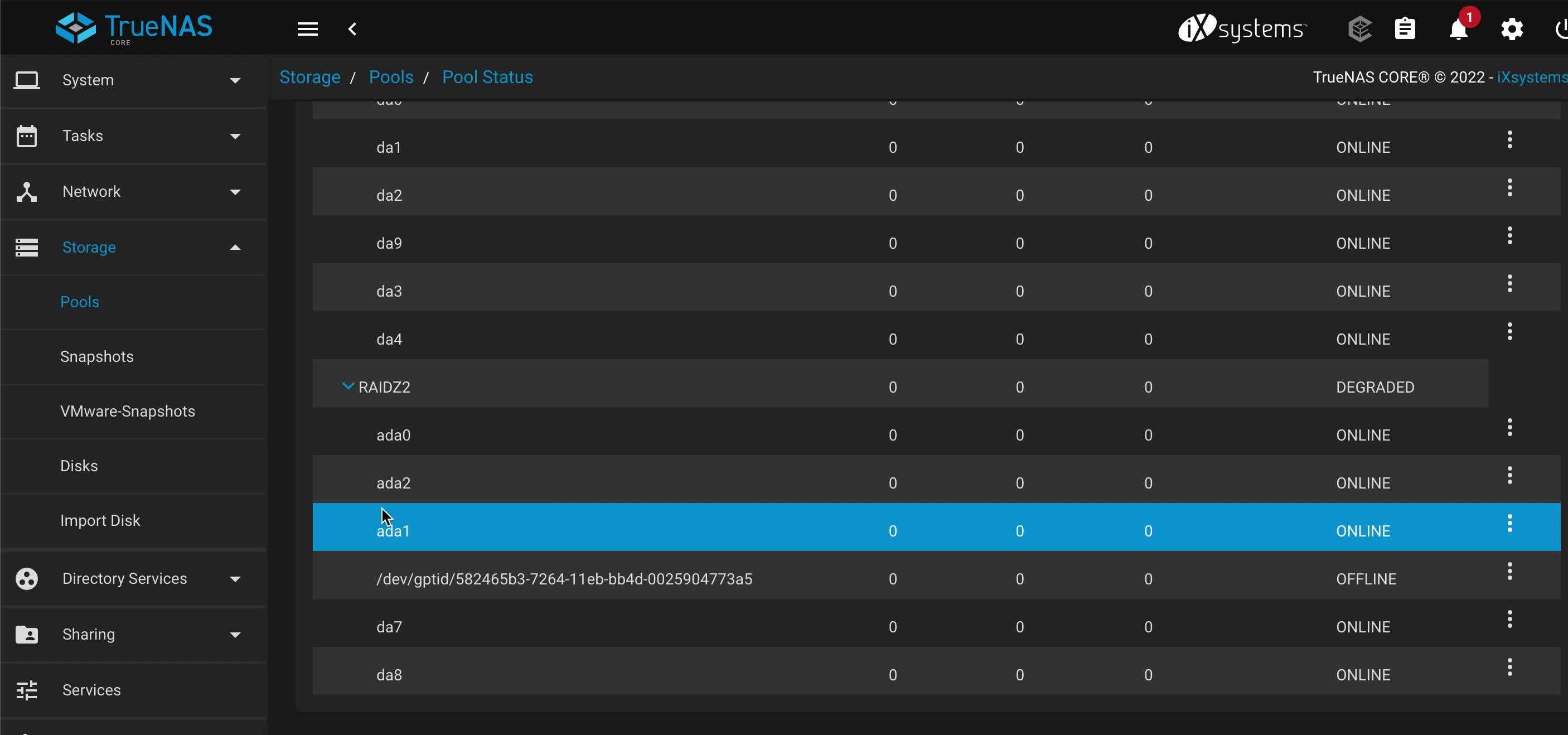

I'm replacing a disk, have done it many times before on previous freenas and truenas versions.
now after upgrade to 13.0-release, when I hit the replace disk button, regardless of whether force is ticked, it's as if the button doesn't do anything. see video capture below:

I have run into this same problem with TRUENAS 13-RELEASE. After selecting the defective drive and choose the replacement drive device name with force activated, nothing happens. No response at all. Reloading GUI has no effect. Re-starting server, doing a manual WIPE of the replacement device and performing the same test has no effect either. On the same system, as a test (I know not recommended), if you go to the command line and issue the replace manually there, it will work and re-silvering happens, however as expected you lose the proper formatting that happens when replace is done from the GUI. I also have a test platform with TRUENAS SCALE 22-release version and performed this same test and all is well there.

Thanks so much, but how does this apply in a scenario where I've removed a drive with read errors and have a new one (/dev/da14) sitting in its slot? I'd happily do the replace on command line if I knew what extra things truenas does other than the replace command. Where you say existing healthy disk, could I take that from any good disk in the pool? (they're all the same drive type)

I had this same issue, found another similar thread that led me to the answer:
Samuel Tai said:
Go to Storage->Disks, and select the new disk. Then click the Wipe button. A quick wipe will overwrite any existing partition table. You should be able to run the replacement procedure afterwards.
It seemed odd to me this was needed since it was a factory new disk. It would also be great to have some error or output generated noting why the button is unresponsive.
