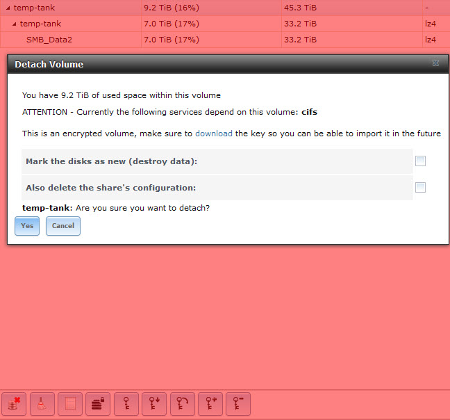

Keep in mind that afterwards, at least I had to do it, to detach the volumes (zpools) from the system (DON'T CHECK THE OPTION TO ERASE DATA).

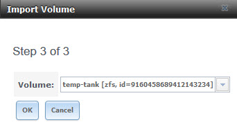

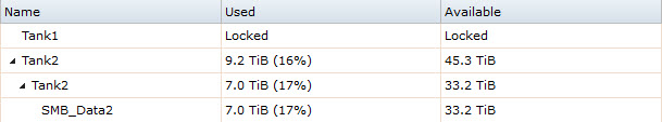

 zpool import temp-tank Tank2 cannot import 'temp-tank': no such pool available
Yeah, with encryption, you would need to unlock the disks first. I've never worked with encryption in FreeNAS (though I've seen plenty of people lose their data that way), so am not sure how you'd do that.
 geli attach -k geli.key daXp1 where X is disk name Enter passphrase:  (Enter the passphrase, repeat geli attach for next disk)NAS# zpool status pool: freenas-boot state: ONLINE scan: scrub repaired 0 in 0h0m with 0 errors on Mon Jun 19 11:03:07 2017 config: NAME STATE READ WRITE CKSUM freenas-boot ONLINE 0 0 0 da0p2 ONLINE 0 0 0
 NAS# zpool import [OLDNAME] [NEWNAME] NAS# zpool export [NEWNAME]
